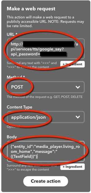

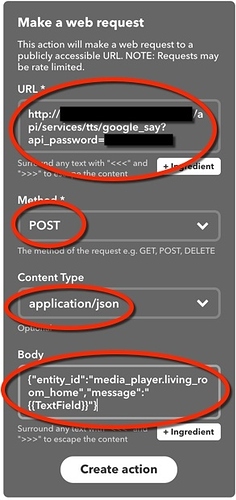

Using IFTTT Maker and the built in Google Cast (starting with HASS 0.35), I’ve successfully created an intercom.

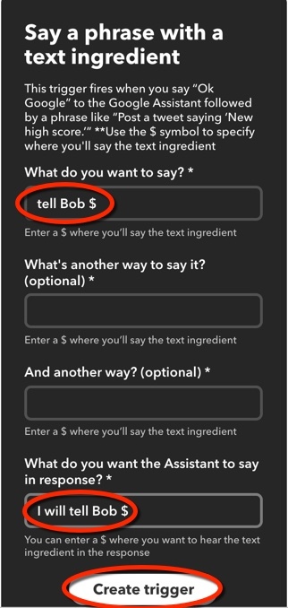

Create one IFTTT applet for each room to be called.
The detailed instructions are at the bottom of this post, but the basics are in creation of the
+ this choosing Google Assistant
+ that choosing Maker
Full details with all screenshots are here
