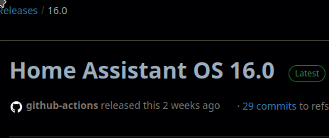

The current version of HAOS is 16.x.
Perhaps the problem?
I doubt seriously that HAOS 10.x will work with 2025.anything.

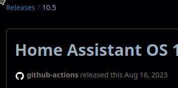

The only option is update to 10.5:
So, almost 2 years old…
The current is…
