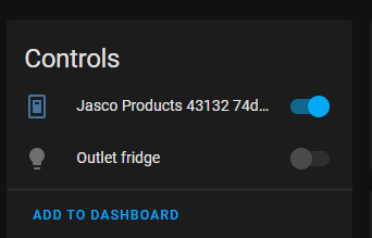

Jasco outlet reporting as 'light' and not, 'switch. Why?
All my other in-wall outlets report as switch. This one is reporting as a light.
According to what I was told when I reported the issue to ZHA, it is how the device reports itself. In other words it was Jasco’s (IMO poor) choice.
What sense at all does it make to have your OUTLET report as a light? Totally stupid choice on Jasco.
You know of any Zwave/Zigbee in-wall outlets with power monitoring that report as a switch?
The Jasco zwave outlets show as switches. All my Jasco zigbee outlets, even the energy monitoring ones, report themselves as lights. The Jasco zigbee in-wall switches do the same.

That worked. Created a switch entity, now I can just disable/hide the previously created light. entity.
