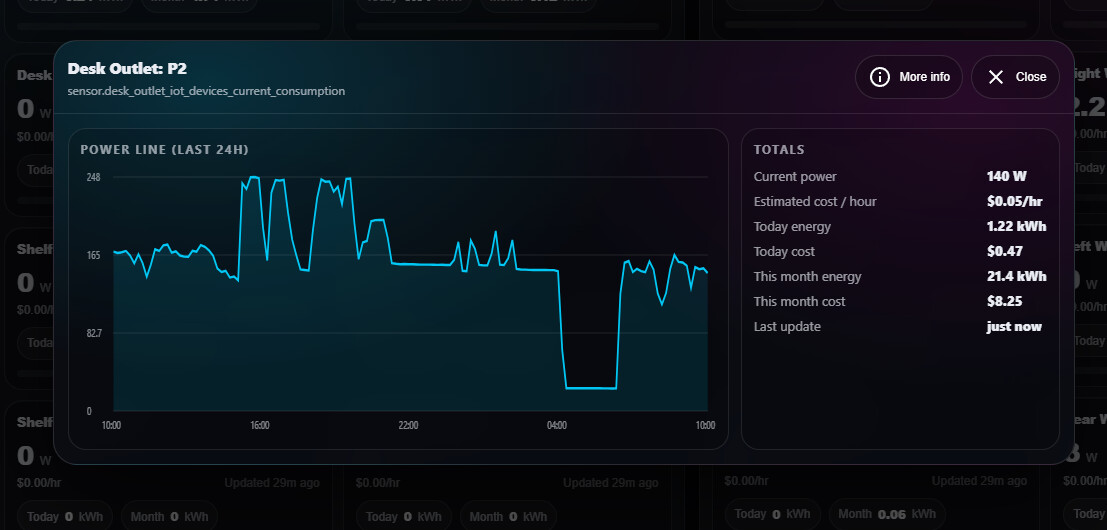

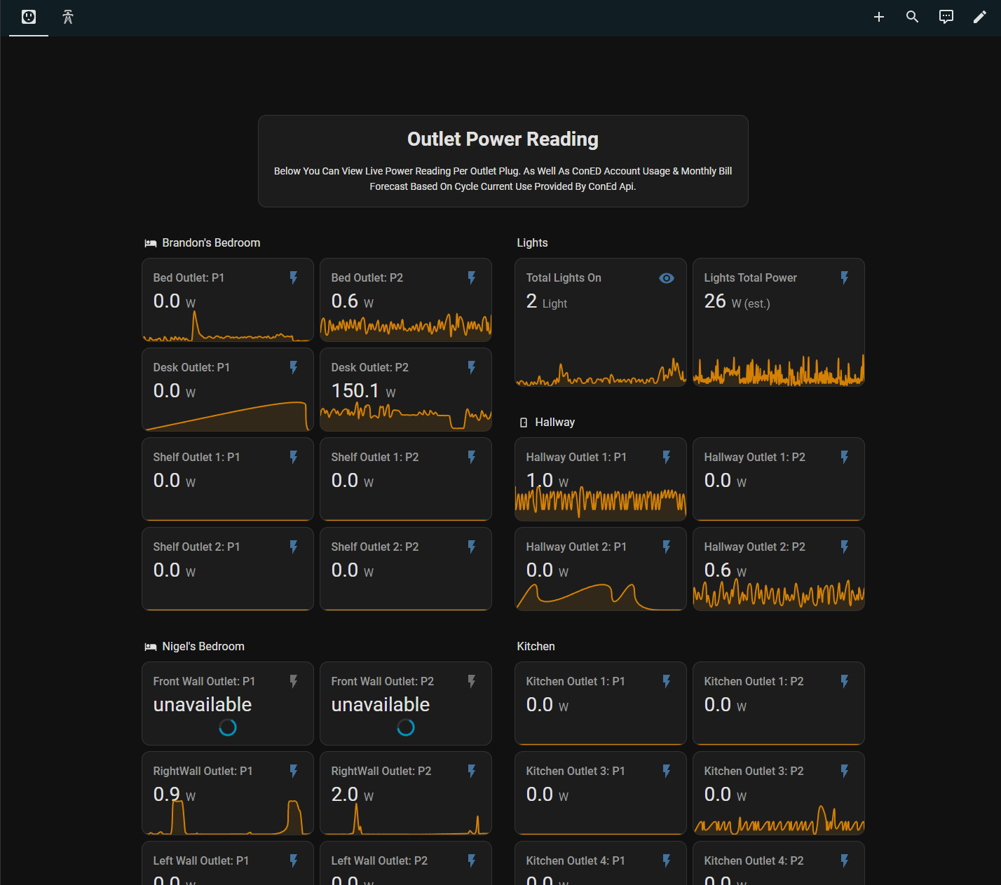

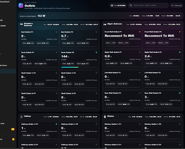

Example (Outlet Monitoring Dashboard)
Here’s a quick comparison of what I recreated for monitoring all my smart outlets:
