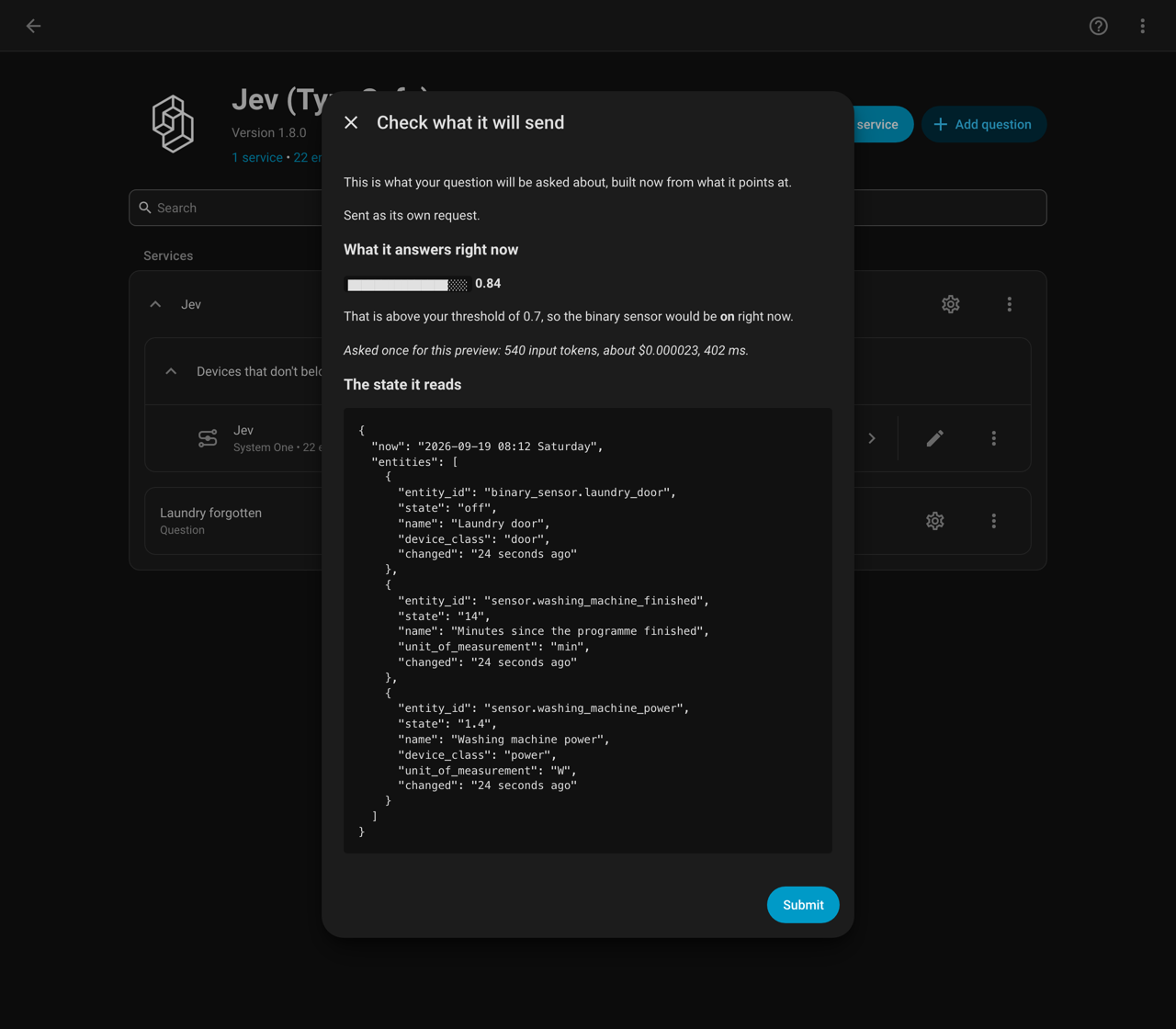

Before a question saves, it shows you the state it will send and asks the question once, so you can see what it answers before the sensor exists.
Here is a simple one. The washing machine is drawing 1.4 W, the door is shut, and it finished 14 minutes ago:

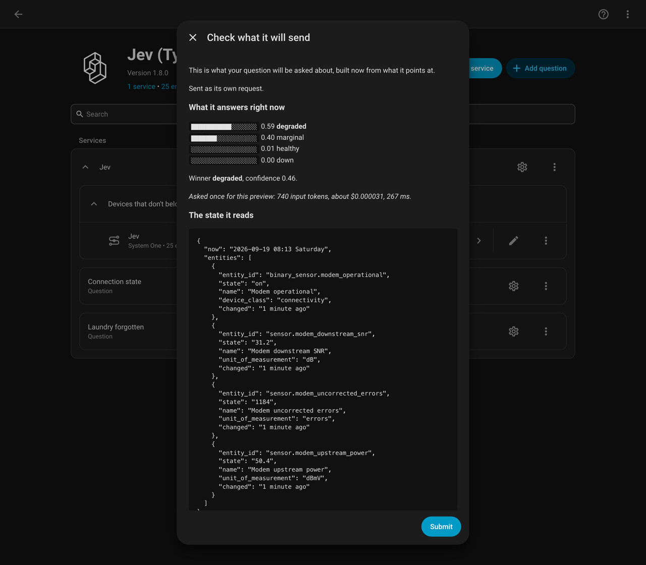

And a more involved one. Four options, and it hands back the whole distribution rather than just a winner. This is my cable modem, where the signal to noise ratio has drifted under the healthy 33 dB and the upstream power is close to its ceiling:
Look at that second answer for a second. It says degraded at 0.59 with marginal right behind at 0.40, and a confidence of 0.46. It is telling me the data is genuinely ambiguous instead of picking one and sounding sure about it. That is the whole reason the actions hand back a confidence figure: my automation can insist on 0.8 before it wakes anybody up.
