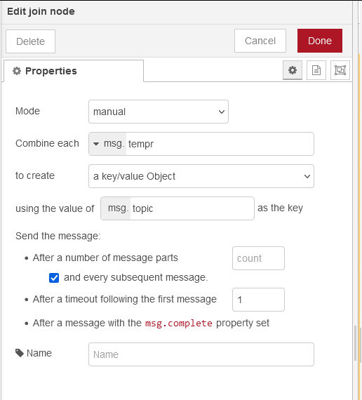

I have a node red flow to change the thermostat based on outdoor weather. It works when I deploy a new node graph, but it doesn’t seem to update dynamically throughout the day. I think the problem is the join node.
An example poll state node:
The red box shows timely updates. The blue box on the right usually stays stale. (All are fresh in the pic bc I just deployed.)
Thanks for any help.

It looks like you have no controls on your join node other than a 1 minute timeout.
You have not posted anything about your function nodes, but my guess is that the function node after the join node require input from all three parts of the flow before the join node .
With your setup then that will not be sure to occur.
It might work in the beginning, but polling data from pirateweather takes long than polling from your own local sensors, so the sync on the polling will slide over time and at one point be more than 1 minute, so you will only get part of the info you need.
You should change your flow to an inject node with a timer set and then pull the info from your sensors in serial, so the flow is not split up.

The timeout join can be a after a number of seconds (it’s seconds, not minutes)
  • so timeout of 1 second means that 1 second will elapse from the arrival of the first message to firing
  • after firing, the node clears its queue
Now, the problem I have found by experimenting is that these two settings can conflict unless it is exactly one or the other.
You have ‘and every subsequent message’ ticked, which seems to turn on the after message parts (even though nothing is set in the count box) and prevents the timeout from working correctly after the first fire.
To make this node work, you MUST either set number of parts, and leave timeout blank, or set message parts and leave timeout blank. That includes the ‘every subsequent message’ as well.
So, if you are using timeout, then all three sensors must change within the 1 second for all three to be joined. I would suggest increasing this a bit, and turn off ‘every subsequent message’. It should then work.
However, the parts may be a better option for you. Using 3 parts means the node waits for 3 messages. Usually this would get out of sync - say two fire, then nothing happens until the third fires which could be much later. This is where the ‘every subsequent message’ might work really well for you.

The problem is in the sliding of timers i. The first nodes.
They are set to deliver data with 15 minutes interval, but they are taking different lengths to complete. Local sensors are much faster than cloud services.
This will eventually mean that you have two replies from the same sensor md be missing one of the others.
