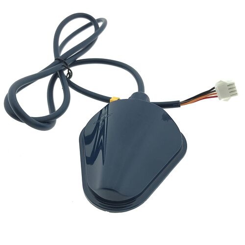

I have bought it last year by fountayn.nl… it costs 265 EUR. It is connected on com1 in the SpaControl

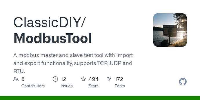

There is a application called “modbus tool” on github in which you can connect to a Modbus TCP device.
If you know the IP you can try to connect to the module. Default port is 502.

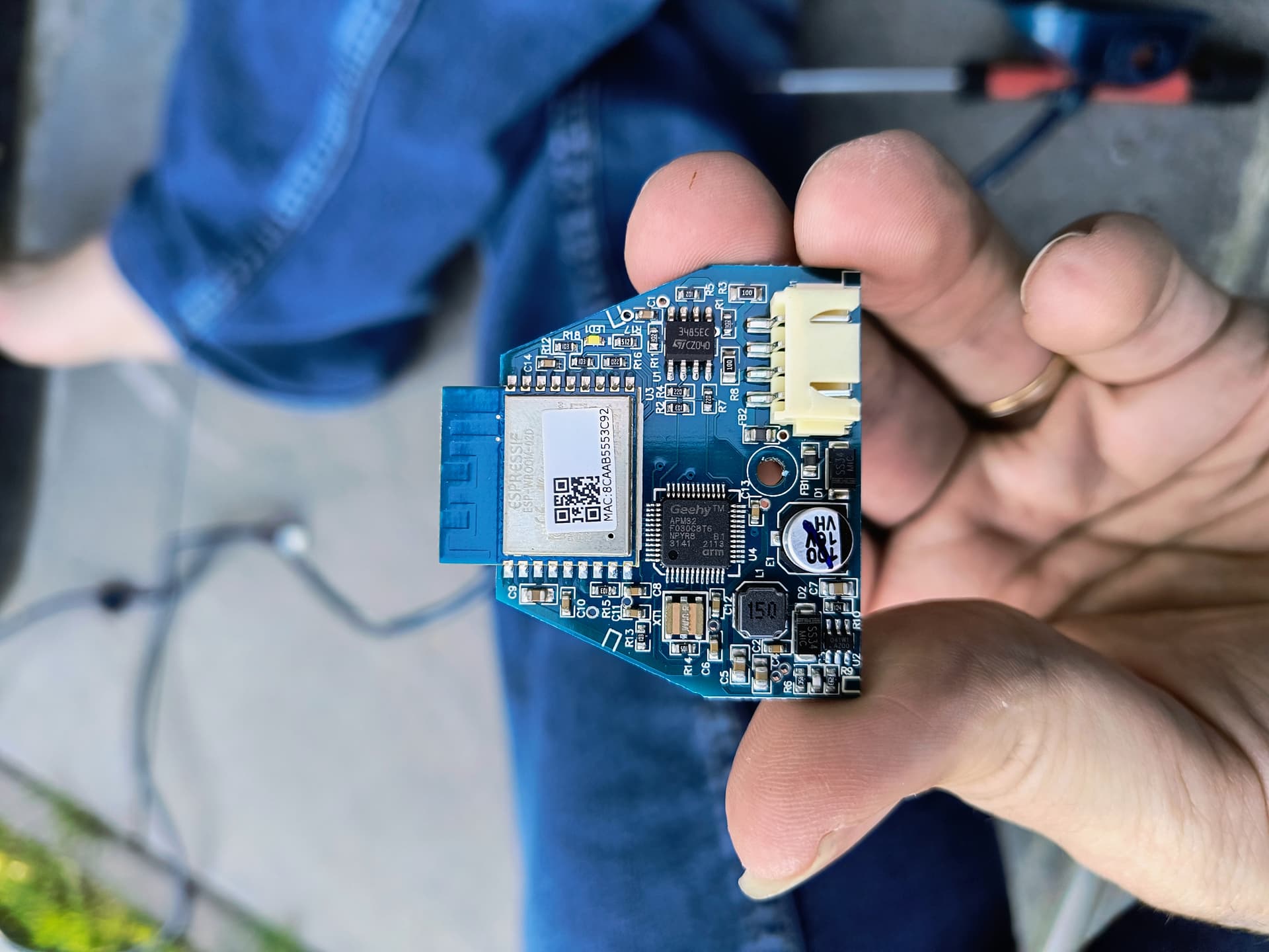

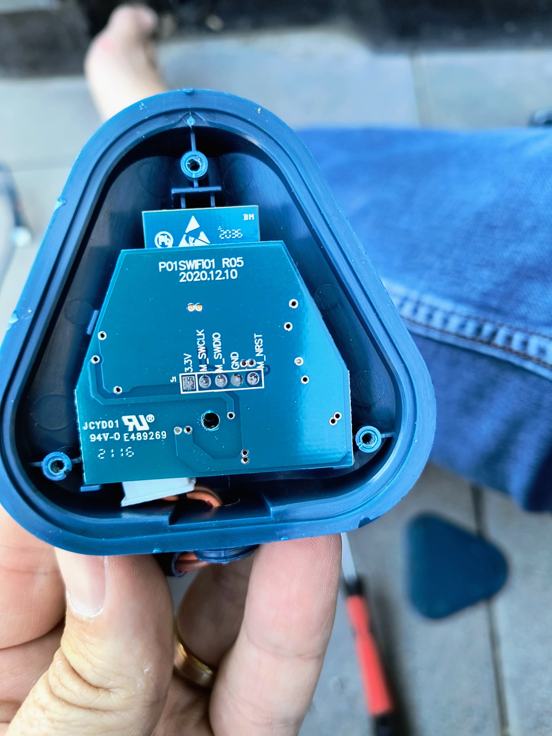

The module cable broke so i unscrewed it and onboard is already an esp module.
I made pictures for you so perhaps this is helpfull or otherwise for other people. In the joyonway there are 2 types of color schema for the wiring. All ports in the main controller can be used and are or master or slave.
The wiring color for the wifi is seen on the original wifi module screenshot or on top row in my picture.
As can seen the cable is on both sides with a connector, in my case a relief as the side cover was blown away by wind while replacing the uv-c light so it was toen apart and is now replaced by only the wire.

Interesting that there is also an APM32(clone of STM32) in the module.
Doesn’t look like the ESP communicates with the pool pcb directly.
That’s probably handled by the APM and the ESP is only used for wireless communication.
