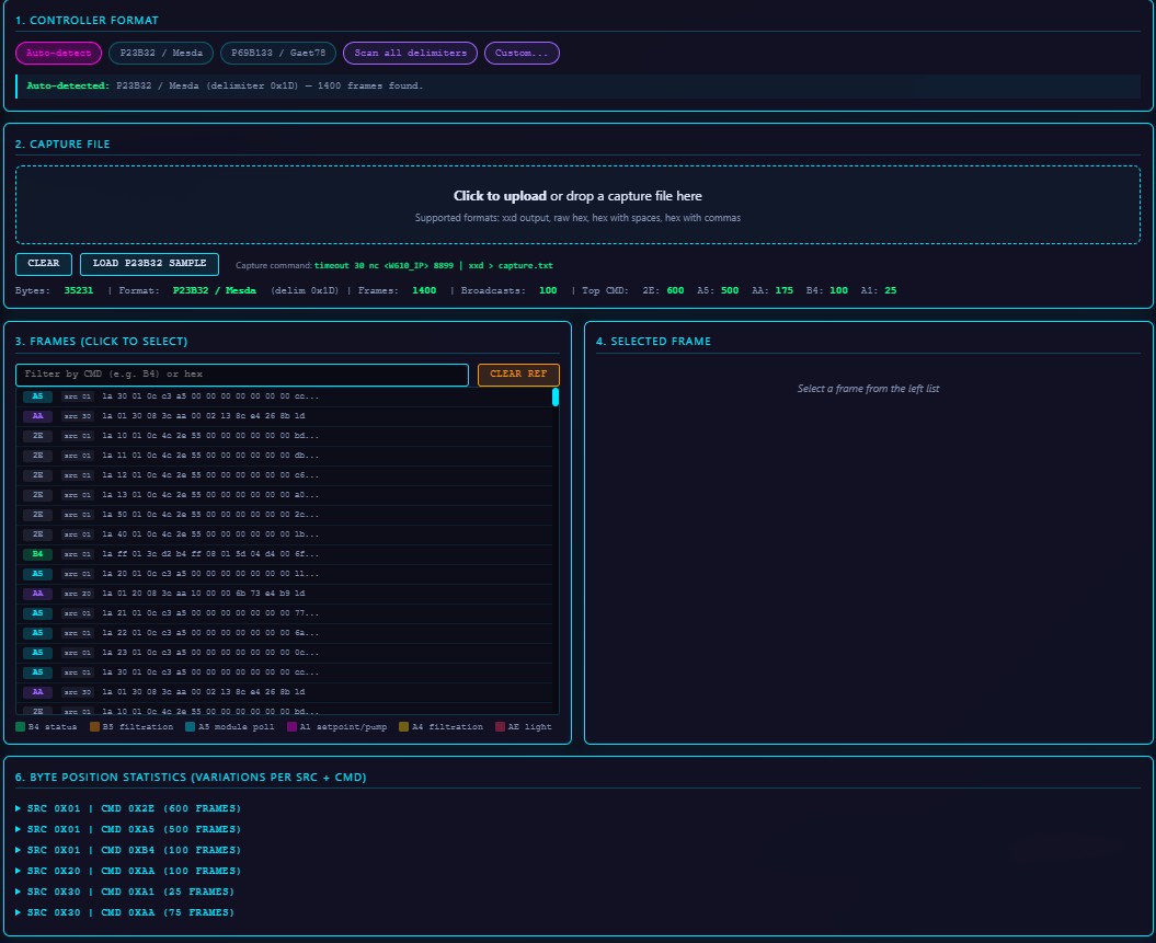

Good news: I just published a small in-browser tool that auto-detects the
frame format of any Joyonway/Mesda/Balboa RS485 capture. It runs entirely
in your browser, no install, no data sent anywhere.
Here is how we can figure out your P20B29 in a few minutes:
  1. Make sure no integration or script is currently connected to your W610
    (only one TCP client at a time can talk to it, otherwise captures fail)
  2. From any Linux machine on your network, run:
    timeout 60 nc YOUR_W610_IP 8899 | xxd > p20b29_capture.txt
    Change the spa state during the capture (setpoint, pump, light, etc.)
    so the diff analysis has something to work with.
  3. Open the tool, drop the capture file in the upload zone, leave
    Auto-detect mode active.
  4. If Auto-detect finds 0 frames, switch to "Scan all delimiters" mode
    (the purple pill). The tool will test 9 common delimiters and tell
    you which one your P20B29 uses.
  5. Post the result here (a screenshot of the stats line and the top
    commands list is enough). From there we will know if your P20B29
    speaks the same dialect as P23B32 or if it is a separate format.

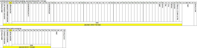

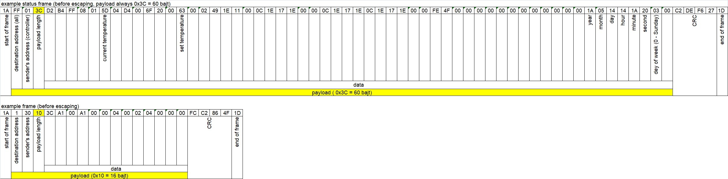

I can see that the frame structure is probably standard.
Two devices are responding; I assume these are the display panel and the Wi-Fi module. This could be very useful in the future.
Please paste the contents of the section of the capture.txt file where you’re capturing the frames, preferably as plain text.
If you have HA, I’d recommend running my script and sharing a screenshot whilst it’s running. I’ve described how to do this earlier.

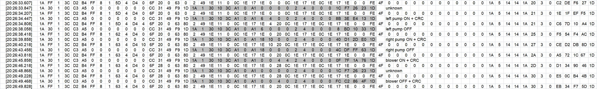

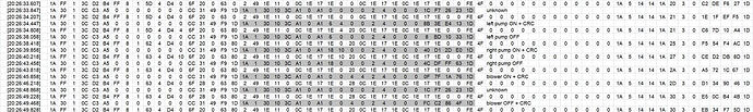

[20:26:32.047] 1a 30 01 0c c3 a5 00 00 00 00 00 00 00 cc 31 49 f9 1d 1a 01 30 08 3c aa 00 02 13 8c e4 26 8b 1d
[20:26:32.087] 1a 10 01 0c 4c 2e 55 00 00 00 00 00 00 bd 5a a0 91 1d
[20:26:32.137] 1a 11 01 0c 4c 2e 55 00 00 00 00 00 00 db f0 a0 63 1d
[20:26:32.187] 1a 12 01 0c 4c 2e 55 00 00 00 00 00 00 c6 13 60 71 1d
[20:26:32.238] 1a 13 01 0c 4c 2e 55 00 00 00 00 00 00 a0 b9 60 83 1d
[20:26:32.287] 1a 50 01 0c 4c 2e 55 00 00 00 00 00 00 2c 01 00 00 1d
[20:26:32.338] 1a 40 01 0c 4c 2e 55 00 00 00 00 00 00 1b 13 01 00 00 1d
[20:26:32.407] 1a ff 01 3c d2 b4 ff 08 01 5d 04 d4 00 6f 20 00 63 00 02 49 1b 15 11 00 0c 1b 15 17 1b 15 00 00 0c 1b 15 17 1b 15 0c 1b 15 17 1b 15 00 00 fe 4f 00 00 00 00 00 00 00 00 00 00 00 00 1b 11 05 14 14 1b 11 1f 03 00 df 4e 83 aa 1d
[20:26:32.447] 1a 20 01 0c c3 a5 00 00 00 00 00 00 00 11 2a 0c e1 1d 1a 01 20 08 3c aa 10 00 00 6b 73 e4 b9 1d
[20:26:32.487] 1a 21 01 0c c3 a5 00 00 00 00 00 00 00 77 80 0c 13 1d
[20:26:32.537] 1a 22 01 0c c3 a5 00 00 00 00 00 00 00 6a 63 cc 01 1d
[20:26:32.587] 1a 23 01 0c c3 a5 00 00 00 00 00 00 00 0c c9 cc f3 1d
[20:26:32.647] 1a 30 01 0c c3 a5 00 00 00 00 00 00 00 cc 31 49 f9 1d 1a 01 30 08 3c aa 00 02 13 8c e4 26 8b 1d
[20:26:32.687] 1a 10 01 0c 4c 2e 55 00 00 00 00 00 00 bd 5a a0 91 1d
[20:26:32.737] 1a 11 01 0c 4c 2e 55 00 00 00 00 00 00 db f0 a0 63 1d
[20:26:32.787] 1a 12 01 0c 4c 2e 55 00 00 00 00 00 00 c6 13 60 71 1d
[20:26:32.838] 1a 13 01 0c 4c 2e 55 00 00 00 00 00 00 a0 b9 60 83 1d
[20:26:32.887] 1a 50 01 0c 4c 2e 55 00 00 00 00 00 00 2c 01 00 00 1d
[20:26:32.947] 1a 40 01 0c 4c 2e 55 00 00 00 00 00 00 1b 13 01 00 00 1d
[20:26:33.008] 1a ff 01 3c d2 b4 ff 08 01 5d 04 d4 00 6f 20 00 63 00 02 49 1b 15 11 00 0c 1b 15 17 1b 15 00 00 0c 1b 15 17 1b 15 0c 1b 15 17 1b 15 00 00 fe 4f 00 00 00 00 00 00 00 00 00 00 00 00 1b 11 05 14 14 1b 11 1f 03 00 df 4e 83 aa 1d
[20:26:33.048] 1a 20 01 0c c3 a5 00 00 00 00 00 00 00 11 2a 0c e1 1d 1a 01 20 08 3c aa 10 00 00 6b 73 e4 b9 1d
[20:26:33.097] 1a 21 01 0c c3 a5 00 00 00 00 00 00 00 77 80 0c 13 1d
[20:26:33.147] 1a 22 01 0c c3 a5 00 00 00 00 00 00 00 6a 63 cc 01 1d
[20:26:33.198] 1a 23 01 0c c3 a5 00 00 00 00 00 00 00 0c c9 cc f3 1d
[20:26:33.247] 1a 30 01 0c c3 a5 00 00 00 00 00 00 00 cc 31 49 f9 1d 1a 01 30 08 3c aa 00 02 13 8c e4 26 8b 1d
[20:26:33.297] 1a 10 01 0c 4c 2e 55 00 00 00 00 00 00 bd 5a a0 91 1d
[20:26:33.347] 1a 11 01 0c 4c 2e 55 00 00 00 00 00 00 db f0 a0 63 1d
[20:26:33.397] 1a 12 01 0c 4c 2e 55 00 00 00 00 00 00 c6 13 60 71 1d
[20:26:33.447] 1a 13 01 0c 4c 2e 55 00 00 00 00 00 00 a0 b9 60 83 1d
[20:26:33.498] 1a 50 01 0c 4c 2e 55 00 00 00 00 00 00 2c 01 00 00 1d
[20:26:33.547] 1a 40 01 0c 4c 2e 55 00 00 00 00 00 00 1b 13 01 00 00 1d
[20:26:33.607] 1a ff 01 3c d2 b4 ff 08 01 5d 04 d4 00 6f 20 00 63 00 02 49 1b 15 11 00 0c 1b 15 17 1b 15 00 00 0c 1b 15 17 1b 15 0c 1b 15 17 1b 15 00 00 fe 4f 00 00 00 00 00 00 00 00 00 00 00 00 1b 11 05 14 14 1b 11 20 03 00 c2 de f6 27 1d
[20:26:33.648] 1a 20 01 0c c3 a5 00 00 00 00 00 00 00 11 2a 0c e1 1d 1a 01 20 08 3c aa 10 00 00 6b 73 e4 b9 1d
[20:26:33.697] 1a 21 01 0c c3 a5 00 00 00 00 00 00 00 77 80 0c 13 1d
[20:26:33.747] 1a 22 01 0c c3 a5 00 00 00 00 00 00 00 6a 63 cc 01 1d
[20:26:33.797] 1a 23 01 0c c3 a5 00 00 00 00 00 00 00 0c c9 cc f3 1d
[20:26:33.847] 1a 30 01 0c c3 a5 00 00 00 00 00 00 00 cc 31 49 f9 1d 1a 01 30 10 3c a1 00 a1 00 00 00 00 02 04 00 00 00 1b 13 f7 26 23 1d
[20:26:33.898] 1a 10 01 0c 4c 2e 55 00 00 00 00 00 00 bd 5a a0 91 1d
[20:26:33.947] 1a 11 01 0c 4c 2e 55 00 00 00 00 00 00 db f0 a0 63 1d
[20:26:33.997] 1a 12 01 0c 4c 2e 55 00 00 00 00 00 00 c6 13 60 71 1d
[20:26:34.047] 1a 13 01 0c 4c 2e 55 00 00 00 00 00 00 a0 b9 60 83 1d
[20:26:34.097] 1a 50 01 0c 4c 2e 55 00 00 00 00 00 00 2c 01 00 00 1d
[20:26:34.147] 1a 40 01 0c 4c 2e 55 00 00 00 00 00 00 1b 13 01 00 00 1d
[20:26:34.207] 1a ff 01 3c d2 b4 ff 08 01 5d 04 d4 00 6f 20 00 63 00 02 49 1b 15 11 00 0c 1b 15 17 1b 15 00 00 0c 1b 15 17 1b 15 0c 1b 15 17 1b 15 00 00 fe 4f 00 00 00 00 00 00 00 00 00 00 00 00 1b 11 05 14 14 1b 11 21 03 00 1b 15 1f ef f5 1d
[20:26:34.247] 1a 20 01 0c c3 a5 00 00 00 00 00 00 00 11 2a 0c e1 1d 1a 01 20 08 3c aa 10 00 00 6b 73 e4 b9 1d
[20:26:34.298] 1a 21 01 0c c3 a5 00 00 00 00 00 00 00 77 80 0c 13 1d
[20:26:34.347] 1a 22 01 0c c3 a5 00 00 00 00 00 00 00 6a 63 cc 01 1d
[20:26:34.397] 1a 23 01 0c c3 a5 00 00 00 00 00 00 00 0c c9 cc f3 1d
[20:26:34.447] 1a 30 01 0c c3 a5 00 00 00 00 00 00 00 cc 31 49 f9 1d 1a 01 30 10 3c a1 00 a1 06 04 00 00 02 04 00 00 00 8b 3e e4 13 1d
[20:26:34.498] 1a 10 01 0c 4c 2e 55 00 00 00 00 00 00 bd 5a a0 91 1d
[20:26:34.547] 1a 11 01 0c 4c 2e 55 00 00 00 00 00 00 db f0 a0 63 1d
[20:26:34.597] 1a 12 01 0c 4c 2e 55 00 00 00 00 00 00 c6 13 60 71 1d
[20:26:34.648] 1a 13 01 0c 4c 2e 55 00 00 00 00 00 00 a0 b9 60 83 1d
[20:26:34.698] 1a 50 01 0c 4c 2e 55 00 00 00 00 00 00 2c 01 00 00 1d
[20:26:34.747] 1a 40 01 0c 4c 2e 55 00 00 00 00 00 00 1b 13 01 00 00 1d
[20:26:34.808] 1a ff 01 3c d2 b4 ff 08 01 5d 04 d4 04 6f 20 00 63 80 02 49 1b 15 11 00 0c 1b 15 17 1b 15 04 20 0c 1b 15 17 1b 15 0c 1b 15 17 1b 15 00 00 fe 4f 00 00 00 00 00 00 00 00 00 00 00 00 1b 11 05 14 14 1b 11 21 03 00 c6 7d 10 a4 1d
[20:26:34.847] 1a 20 01 0c c3 a5 00 00 00 00 00 00 00 11 2a 0c e1 1d 1a 01 20 08 3c aa 10 00 00 6b 73 e4 b9 1d
[20:26:34.898] 1a 21 01 0c c3 a5 00 00 00 00 00 00 00 77 80 0c 13 1d
[20:26:34.947] 1a 22 01 0c c3 a5 00 00 00 00 00 00 00 6a 63 cc 01 1d
[20:26:34.998] 1a 23 01 0c c3 a5 00 00 00 00 00 00 00 0c c9 cc f3 1d
[20:26:35.048] 1a 30 01 0c c3 a5 00 00 00 00 00 00 00 cc 31 49 f9 1d 1a 01 30 08 3c aa 00 02 13 8c e4 26 8b 1d
[20:26:35.098] 1a 10 01 0c 4c 2e 55 00 00 00 00 00 00 bd 5a a0 91 1d
[20:26:35.147] 1a 11 01 0c 4c 2e 55 00 00 00 00 00 00 db f0 a0 63 1d
[20:26:35.198] 1a 12 01 0c 4c 2e 55 00 00 00 00 00 00 c6 13 60 71 1d
[20:26:35.247] 1a 13 01 0c 4c 2e 55 00 00 00 00 00 00 a0 b9 60 83 1d
[20:26:35.298] 1a 50 01 0c 4c 2e 55 00 00 00 00 00 00 2c 01 00 00 1d
[20:26:35.348] 1a 40 01 0c 4c 2e 55 00 00 00 00 00 00 1b 13 01 00 00 1d
[20:26:35.408] 1a ff 01 3c d2 b4 ff 08 01 5d 04 d4 04 6f 20 00 63 80 02 49 1b 15 11 00 0c 1b 15 17 1b 15 04 20 0c 1b 15 17 1b 15 0c 1b 15 17 1b 15 00 00 fe 4f 00 00 00 00 00 00 00 00 00 00 00 00 1b 11 05 14 14 1b 11 22 03 00 15 22 fb d6 1d
[20:26:35.447] 1a 20 01 0c c3 a5 00 00 00 00 00 00 00 11 2a 0c e1 1d 1a 01 20 08 3c aa 10 00 00 6b 73 e4 b9 1d
[20:26:35.498] 1a 21 01 0c c3 a5 00 00 00 00 00 00 00 77 80 0c 13 1d
[20:26:35.547] 1a 22 01 0c c3 a5 00 00 00 00 00 00 00 6a 63 cc 01 1d
[20:26:35.598] 1a 23 01 0c c3 a5 00 00 00 00 00 00 00 0c c9 cc f3 1d
[20:26:35.648] 1a 30 01 0c c3 a5 00 00 00 00 00 00 00 cc 31 49 f9 1d 1a 01 30 08 3c aa 00 02 13 8c e4 26 8b 1d
[20:26:35.698] 1a 10 01 0c 4c 2e 55 00 00 00 00 00 00 bd 5a a0 91 1d
[20:26:35.748] 1a 11 01 0c 4c 2e 55 00 00 00 00 00 00 db f0 a0 63 1d
[20:26:35.798] 1a 12 01 0c 4c 2e 55 00 00 00 00 00 00 c6 13 60 71 1d
[20:26:35.848] 1a 13 01 0c 4c 2e 55 00 00 00 00 00 00 a0 b9 60 83 1d
[20:26:35.898] 1a 50 01 0c 4c 2e 55 00 00 00 00 00 00 2c 01 00 00 1d
[20:26:35.947] 1a 40 01 0c 4c 2e 55 00 00 00 00 00 00 1b 13 01 00 00 1d
[20:26:36.008] 1a ff 01 3c d2 b4 ff 08 01 5f 04 d4 04 6f 20 00 63 80 02 49 1b 15 11 00 0c 1b 15 17 1b 15 04 20 0c 1b 15 17 1b 15 0c 1b 15 17 1b 15 00 00 fe 4f 00 00 00 00 00 00 00 00 00 00 00 00 1b 11 05 14 14 1b 11 22 03 00 e5 14 25 3a 1d
[20:26:36.047] 1a 20 01 0c c3 a5 00 00 00 00 00 00 00 11 2a 0c e1 1d 1a 01 20 08 3c aa 10 00 00 6b 73 e4 b9 1d
[20:26:36.097] 1a 21 01 0c c3 a5 00 00 00 00 00 00 00 77 80 0c 13 1d
[20:26:36.148] 1a 22 01 0c c3 a5 00 00 00 00 00 00 00 6a 63 cc 01 1d
[20:26:36.198] 1a 23 01 0c c3 a5 00 00 00 00 00 00 00 0c c9 cc f3 1d
[20:26:36.248] 1a 30 01 0c c3 a5 00 00 00 00 00 00 00 cc 31 49 f9 1d 1a 01 30 08 3c aa 00 02 13 8c e4 26 8b 1d
[20:26:36.297] 1a 10 01 0c 4c 2e 55 00 00 00 00 00 00 bd 5a a0 91 1d
[20:26:36.348] 1a 11 01 0c 4c 2e 55 00 00 00 00 00 00 db f0 a0 63 1d
[20:26:36.398] 1a 12 01 0c 4c 2e 55 00 00 00 00 00 00 c6 13 60 71 1d
[20:26:36.448] 1a 13 01 0c 4c 2e 55 00 00 00 00 00 00 a0 b9 60 83 1d
[20:26:36.497] 1a 50 01 0c 4c 2e 55 00 00 00 00 00 00 2c 01 00 00 1d
[20:26:36.548] 1a 40 01 0c 4c 2e 55 00 00 00 00 00 00 1b 13 01 00 00 1d
[20:26:36.608] 1a ff 01 3c d2 b4 ff 08 01 60 04 d4 04 6f 20 00 63 80 02 49 1b 15 11 00 0c 1b 15 17 1b 15 04 20 0c 1b 15 17 1b 15 0c 1b 15 17 1b 15 00 00 fe 4f 00 00 00 00 00 00 00 00 00 00 00 00 1b 11 05 14 14 1b 11 23 03 00 70 5d 10 98 1d
[20:26:36.647] 1a 20 01 0c c3 a5 00 00 00 00 00 00 00 11 2a 0c e1 1d 1a 01 20 08 3c aa 10 00 00 6b 73 e4 b9 1d
[20:26:36.697] 1a 21 01 0c c3 a5 00 00 00 00 00 00 00 77 80 0c 13 1d
[20:26:36.747] 1a 22 01 0c c3 a5 00 00 00 00 00 00 00 6a 63 cc 01 1d
[20:26:36.798] 1a 23 01 0c c3 a5 00 00 00 00 00 00 00 0c c9 cc f3 1d
[20:26:36.848] 1a 30 01 0c c3 a5 00 00 00 00 00 00 00 cc 31 49 f9 1d 1a 01 30 08 3c aa 00 02 13 8c e4 26 8b 1d
[20:26:36.898] 1a 10 01 0c 4c 2e 55 00 00 00 00 00 00 bd 5a a0 91 1d
[20:26:36.948] 1a 11 01 0c 4c 2e 55 00 00 00 00 00 00 db f0 a0 63 1d
[20:26:36.998] 1a 12 01 0c 4c 2e 55 00 00 00 00 00 00 c6 13 60 71 1d
[20:26:37.048] 1a 13 01 0c 4c 2e 55 00 00 00 00 00 00 a0 b9 60 83 1d
[20:26:37.098] 1a 50 01 0c 4c 2e 55 00 00 00 00 00 00 2c 01 00 00 1d
[20:26:37.148] 1a 40 01 0c 4c 2e 55 00 00 00 00 00 00 1b 13 01 00 00 1d
[20:26:37.218] 1a ff 01 3c d2 b4 ff 08 01 61 04 d4 04 6f 20 00 63 80 02 49 1b 15 11 00 0c 1b 15 17 1b 15 04 20 0c 1b 15 17 1b 15 0c 1b 15 17 1b 15 00 00 fe 4f 00 00 00 00 00 00 00 00 00 00 00 00 1b 11 05 14 14 1b 11 24 03 00 72 38 b0 d9 1d
[20:26:37.248] 1a 20 01 0c c3 a5 00 00 00 00 00 00 00 11 2a 0c e1 1d 1a 01 20 08 3c aa 10 00 00 6b 73 e4 b9 1d
[20:26:37.298] 1a 21 01 0c c3 a5 00 00 00 00 00 00 00 77 80 0c 13 1d
[20:26:37.348] 1a 22 01 0c c3 a5 00 00 00 00 00 00 00 6a 63 cc 01 1d
[20:26:37.398] 1a 23 01 0c c3 a5 00 00 00 00 00 00 00 0c c9 cc f3 1d
[20:26:37.448] 1a 30 01 0c c3 a5 00 00 00 00 00 00 00 cc 31 49 f9 1d 1a 01 30 08 3c aa 00 02 13 8c e4 26 8b 1d
[20:26:37.498] 1a 10 01 0c 4c 2e 55 00 00 00 00 00 00 bd 5a a0 91 1d
[20:26:37.548] 1a 11 01 0c 4c 2e 55 00 00 00 00 00 00 db f0 a0 63 1d
[20:26:37.598] 1a 12 01 0c 4c 2e 55 00 00 00 00 00 00 c6 13 60 71 1d
[20:26:37.648] 1a 13 01 0c 4c 2e 55 00 00 00 00 00 00 a0 b9 60 83 1d
[20:26:37.698] 1a 50 01 0c 4c 2e 55 00 00 00 00 00 00 2c 01 00 00 1d
[20:26:37.748] 1a 40 01 0c 4c 2e 55 00 00 00 00 00 00 1b 13 01 00 00 1d
[20:26:37.818] 1a ff 01 3c d2 b4 ff 08 01 62 04 d4 04 6f 20 00 63 80 02 49 1b 15 11 00 0c 1b 15 17 1b 15 04 20 0c 1b 15 17 1b 15 0c 1b 15 17 1b 15 00 00 fe 4f 00 00 00 00 00 00 00 00 00 00 00 00 1b 11 05 14 14 1b 11 24 03 00 fa 15 01 43 1d
[20:26:37.858] 1a 20 01 0c c3 a5 00 00 00 00 00 00 00 11 2a 0c e1 1d 1a 01 20 08 3c aa 10 00 00 6b 73 e4 b9 1d
[20:26:37.898] 1a 21 01 0c c3 a5 00 00 00 00 00 00 00 77 80 0c 13 1d
[20:26:37.948] 1a 22 01 0c c3 a5 00 00 00 00 00 00 00 6a 63 cc 01 1d
[20:26:37.998] 1a 23 01 0c c3 a5 00 00 00 00 00 00 00 0c c9 cc f3 1d
[20:26:38.058] 1a 30 01 0c c3 a5 00 00 00 00 00 00 00 cc 31 49 f9 1d 1a 01 30 10 3c a1 00 a1 06 00 00 00 02 04 00 00 00 08 bd 10 33 1d
[20:26:38.098] 1a 10 01 0c 4c 2e 55 00 00 00 00 00 00 bd 5a a0 91 1d
[20:26:38.148] 1a 11 01 0c 4c 2e 55 00 00 00 00 00 00 db f0 a0 63 1d
[20:26:38.198] 1a 12 01 0c 4c 2e 55 00 00 00 00 00 00 c6 13 60 71 1d
[20:26:38.248] 1a 13 01 0c 4c 2e 55 00 00 00 00 00 00 a0 b9 60 83 1d
[20:26:38.298] 1a 50 01 0c 4c 2e 55 00 00 00 00 00 00 2c 01 00 00 1d
[20:26:38.348] 1a 40 01 0c 4c 2e 55 00 00 00 00 00 00 1b 13 01 00 00 1d
[20:26:38.418] 1a ff 01 3c d2 b4 ff 08 01 62 04 d4 00 6f 20 00 63 80 02 49 1b 15 11 00 0c 1b 15 17 1b 15 00 20 0c 1b 15 17 1b 15 0c 1b 15 17 1b 15 00 00 fe 4f 00 00 00 00 00 00 00 00 00 00 00 00 1b 11 05 14 14 1b 11 25 03 00 f5 54 f4 ac 1d
[20:26:38.458] 1a 20 01 0c c3 a5 00 00 00 00 00 00 00 11 2a 0c e1 1d 1a 01 20 08 3c aa 10 00 00 6b 73 e4 b9 1d
[20:26:38.498] 1a 21 01 0c c3 a5 00 00 00 00 00 00 00 77 80 0c 13 1d
[20:26:38.548] 1a 22 01 0c c3 a5 00 00 00 00 00 00 00 6a 63 cc 01 1d
[20:26:38.598] 1a 23 01 0c c3 a5 00 00 00 00 00 00 00 0c c9 cc f3 1d
[20:26:38.648] 1a 30 01 0c c3 a5 00 00 00 00 00 00 00 cc 31 49 f9 1d 1a 01 30 08 3c aa 00 02 13 8c e4 26 8b 1d
[20:26:38.698] 1a 10 01 0c 4c 2e 55 00 00 00 00 00 00 bd 5a a0 91 1d
[20:26:38.748] 1a 11 01 0c 4c 2e 55 00 00 00 00 00 00 db f0 a0 63 1d
[20:26:38.798] 1a 12 01 0c 4c 2e 55 00 00 00 00 00 00 c6 13 60 71 1d
[20:26:38.848] 1a 13 01 0c 4c 2e 55 00 00 00 00 00 00 a0 b9 60 83 1d
[20:26:38.898] 1a 50 01 0c 4c 2e 55 00 00 00 00 00 00 2c 01 00 00 1d
[20:26:38.948] 1a 40 01 0c 4c 2e 55 00 00 00 00 00 00 1b 13 01 00 00 1d
[20:26:39.018] 1a ff 01 3c d2 b4 ff 08 01 63 04 d4 00 6f 20 00 63 80 02 49 1b 15 11 00 0c 1b 15 17 1b 15 00 20 0c 1b 15 17 1b 15 0c 1b 15 17 1b 15 00 00 fe 4f 00 00 00 00 00 00 00 00 00 00 00 00 1b 11 05 14 14 1b 11 25 03 00 8d 4f 9b da 1d
[20:26:39.058] 1a 20 01 0c c3 a5 00 00 00 00 00 00 00 11 2a 0c e1 1d 1a 01 20 08 3c aa 10 00 00 6b 73 e4 b9 1d
[20:26:39.098] 1a 21 01 0c c3 a5 00 00 00 00 00 00 00 77 80 0c 13 1d
[20:26:39.148] 1a 22 01 0c c3 a5 00 00 00 00 00 00 00 6a 63 cc 01 1d
[20:26:39.198] 1a 23 01 0c c3 a5 00 00 00 00 00 00 00 0c c9 cc f3 1d
[20:26:39.248] 1a 30 01 0c c3 a5 00 00 00 00 00 00 00 cc 31 49 f9 1d 1a 01 30 08 3c aa 00 02 13 8c e4 26 8b 1d
[20:26:39.298] 1a 10 01 0c 4c 2e 55 00 00 00 00 00 00 bd 5a a0 91 1d
[20:26:39.348] 1a 11 01 0c 4c 2e 55 00 00 00 00 00 00 db f0 a0 63 1d
[20:26:39.398] 1a 12 01 0c 4c 2e 55 00 00 00 00 00 00 c6 13 60 71 1d
[20:26:39.448] 1a 13 01 0c 4c 2e 55 00 00 00 00 00 00 a0 b9 60 83 1d
[20:26:39.498] 1a 50 01 0c 4c 2e 55 00 00 00 00 00 00 2c 01 00 00 1d
[20:26:39.548] 1a 40 01 0c 4c 2e 55 00 00 00 00 00 00 1b 13 01 00 00 1d
[20:26:39.618] 1a ff 01 3c d2 b4 ff 08 01 63 04 d4 00 6f 20 00 63 80 02 49 1b 15 11 00 0c 1b 15 17 1b 15 00 20 0c 1b 15 17 1b 15 0c 1b 15 17 1b 15 00 00 fe 4f 00 00 00 00 00 00 00 00 00 00 00 00 1b 11 05 14 14 1b 11 26 03 00 5e 10 70 a8 1d
[20:26:39.658] 1a 20 01 0c c3 a5 00 00 00 00 00 00 00 11 2a 0c e1 1d 1a 01 20 08 3c aa 10 00 00 6b 73 e4 b9 1d
[20:26:39.698] 1a 21 01 0c c3 a5 00 00 00 00 00 00 00 77 80 0c 13 1d
[20:26:39.748] 1a 22 01 0c c3 a5 00 00 00 00 00 00 00 6a 63 cc 01 1d
[20:26:39.798] 1a 23 01 0c c3 a5 00 00 00 00 00 00 00 0c c9 cc f3 1d
[20:26:39.858] 1a 30 01 0c c3 a5 00 00 00 00 00 00 00 cc 31 49 f9 1d 1a 01 30 10 3c a1 00 a1 18 10 00 00 02 04 00 00 00 40 d1 2d e0 1d
[20:26:39.898] 1a 10 01 0c 4c 2e 55 00 00 00 00 00 00 bd 5a a0 91 1d
[20:26:39.948] 1a 11 01 0c 4c 2e 55 00 00 00 00 00 00 db f0 a0 63 1d
[20:26:39.998] 1a 12 01 0c 4c 2e 55 00 00 00 00 00 00 c6 13 60 71 1d
[20:26:40.048] 1a 13 01 0c 4c 2e 55 00 00 00 00 00 00 a0 b9 60 83 1d
[20:26:40.098] 1a 50 01 0c 4c 2e 55 00 00 00 00 00 00 2c 01 00 00 1d
[20:26:40.148] 1a 40 01 0c 4c 2e 55 00 00 00 00 00 00 1b 13 01 00 00 1d
[20:26:40.218] 1a ff 01 3c d2 b4 ff 08 01 63 04 d4 10 6f 20 00 63 80 02 49 1b 15 11 00 0c 1b 15 17 1b 15 10 20 0c 1b 15 17 1b 15 0c 1b 15 17 1b 15 00 00 fe 4f 00 00 00 00 00 00 00 00 00 00 00 00 1b 11 05 14 14 1b 11 27 03 00 ce d2 db 8d 1d
[20:26:40.258] 1a 20 01 0c c3 a5 00 00 00 00 00 00 00 11 2a 0c e1 1d 1a 01 20 08 3c aa 10 00 00 6b 73 e4 b9 1d
[20:26:40.298] 1a 21 01 0c c3 a5 00 00 00 00 00 00 00 77 80 0c 13 1d
[20:26:40.348] 1a 22 01 0c c3 a5 00 00 00 00 00 00 00 6a 63 cc 01 1d
[20:26:40.398] 1a 23 01 0c c3 a5 00 00 00 00 00 00 00 0c c9 cc f3 1d
[20:26:40.458] 1a 30 01 0c c3 a5 00 00 00 00 00 00 00 cc 31 49 f9 1d 1a 01 30 08 3c aa 00 02 13 8c e4 26 8b 1d
[20:26:40.498] 1a 10 01 0c 4c 2e 55 00 00 00 00 00 00 bd 5a a0 91 1d
[20:26:40.548] 1a 11 01 0c 4c 2e 55 00 00 00 00 00 00 db f0 a0 63 1d
[20:26:40.598] 1a 12 01 0c 4c 2e 55 00 00 00 00 00 00 c6 13 60 71 1d
[20:26:40.648] 1a 13 01 0c 4c 2e 55 00 00 00 00 00 00 a0 b9 60 83 1d
[20:26:40.698] 1a 50 01 0c 4c 2e 55 00 00 00 00 00 00 2c 01 00 00 1d
[20:26:40.748] 1a 40 01 0c 4c 2e 55 00 00 00 00 00 00 1b 13 01 00 00 1d
[20:26:40.818] 1a ff 01 3c d2 b4 ff 08 01 63 04 d4 10 6f 20 00 63 80 02 49 1b 15 11 00 0c 1b 15 17 1b 15 10 20 0c 1b 15 17 1b 15 0c 1b 15 17 1b 15 00 00 fe 4f 00 00 00 00 00 00 00 00 00 00 00 00 1b 11 05 14 14 1b 11 27 03 00 ce d2 db 8d 1d
[20:26:40.858] 1a 20 01 0c c3 a5 00 00 00 00 00 00 00 11 2a 0c e1 1d 1a 01 20 08 3c aa 10 00 00 6b 73 e4 b9 1d
[20:26:40.898] 1a 21 01 0c c3 a5 00 00 00 00 00 00 00 77 80 0c 13 1d
[20:26:40.948] 1a 22 01 0c c3 a5 00 00 00 00 00 00 00 6a 63 cc 01 1d
[20:26:40.998] 1a 23 01 0c c3 a5 00 00 00 00 00 00 00 0c c9 cc f3 1d
[20:26:41.058] 1a 30 01 0c c3 a5 00 00 00 00 00 00 00 cc 31 49 f9 1d 1a 01 30 08 3c aa 00 02 13 8c e4 26 8b 1d
[20:26:41.098] 1a 10 01 0c 4c 2e 55 00 00 00 00 00 00 bd 5a a0 91 1d
[20:26:41.148] 1a 11 01 0c 4c 2e 55 00 00 00 00 00 00 db f0 a0 63 1d
[20:26:41.198] 1a 12 01 0c 4c 2e 55 00 00 00 00 00 00 c6 13 60 71 1d
[20:26:41.248] 1a 13 01 0c 4c 2e 55 00 00 00 00 00 00 a0 b9 60 83 1d
[20:26:41.298] 1a 50 01 0c 4c 2e 55 00 00 00 00 00 00 2c 01 00 00 1d
[20:26:41.348] 1a 40 01 0c 4c 2e 55 00 00 00 00 00 00 1b 13 01 00 00 1d
[20:26:41.418] 1a ff 01 3c d2 b4 ff 08 01 63 04 d4 10 6f 20 00 63 80 02 49 1b 15 11 00 0c 1b 15 17 1b 15 10 20 0c 1b 15 17 1b 15 0c 1b 15 17 1b 15 00 00 fe 4f 00 00 00 00 00 00 00 00 00 00 00 00 1b 11 05 14 14 1b 11 28 03 00 e6 ef 5c 30 1d
[20:26:41.458] 1a 20 01 0c c3 a5 00 00 00 00 00 00 00 11 2a 0c e1 1d 1a 01 20 08 3c aa 10 00 00 6b 73 e4 b9 1d
[20:26:41.498] 1a 21 01 0c c3 a5 00 00 00 00 00 00 00 77 80 0c 13 1d
[20:26:41.548] 1a 22 01 0c c3 a5 00 00 00 00 00 00 00 6a 63 cc 01 1d
[20:26:41.598] 1a 23 01 0c c3 a5 00 00 00 00 00 00 00 0c c9 cc f3 1d
[20:26:41.658] 1a 30 01 0c c3 a5 00 00 00 00 00 00 00 cc 31 49 f9 1d 1a 01 30 08 3c aa 00 02 13 8c e4 26 8b 1d
[20:26:41.698] 1a 10 01 0c 4c 2e 55 00 00 00 00 00 00 bd 5a a0 91 1d
[20:26:41.748] 1a 11 01 0c 4c 2e 55 00 00 00 00 00 00 db f0 a0 63 1d
[20:26:41.798] 1a 12 01 0c 4c 2e 55 00 00 00 00 00 00 c6 13 60 71 1d
[20:26:41.848] 1a 13 01 0c 4c 2e 55 00 00 00 00 00 00 a0 b9 60 83 1d
[20:26:41.898] 1a 50 01 0c 4c 2e 55 00 00 00 00 00 00 2c 01 00 00 1d
[20:26:41.948] 1a 40 01 0c 4c 2e 55 00 00 00 00 00 00 1b 13 01 00 00 1d
[20:26:42.018] 1a ff 01 3c d2 b4 ff 08 01 63 04 d4 10 6f 20 00 63 80 02 49 1b 15 11 00 0c 1b 15 17 1b 15 10 20 0c 1b 15 17 1b 15 0c 1b 15 17 1b 15 00 00 fe 4f 00 00 00 00 00 00 00 00 00 00 00 00 1b 11 05 14 14 1b 11 28 03 00 e6 ef 5c 30 1d
[20:26:42.058] 1a 20 01 0c c3 a5 00 00 00 00 00 00 00 11 2a 0c e1 1d 1a 01 20 08 3c aa 10 00 00 6b 73 e4 b9 1d
[20:26:42.098] 1a 21 01 0c c3 a5 00 00 00 00 00 00 00 77 80 0c 13 1d
[20:26:42.148] 1a 22 01 0c c3 a5 00 00 00 00 00 00 00 6a 63 cc 01 1d
[20:26:42.198] 1a 23 01 0c c3 a5 00 00 00 00 00 00 00 0c c9 cc f3 1d
[20:26:42.258] 1a 30 01 0c c3 a5 00 00 00 00 00 00 00 cc 31 49 f9 1d 1a 01 30 08 3c aa 00 02 13 8c e4 26 8b 1d
[20:26:42.298] 1a 10 01 0c 4c 2e 55 00 00 00 00 00 00 bd 5a a0 91 1d
[20:26:42.348] 1a 11 01 0c 4c 2e 55 00 00 00 00 00 00 db f0 a0 63 1d
[20:26:42.398] 1a 12 01 0c 4c 2e 55 00 00 00 00 00 00 c6 13 60 71 1d
[20:26:42.448] 1a 13 01 0c 4c 2e 55 00 00 00 00 00 00 a0 b9 60 83 1d
[20:26:42.498] 1a 50 01 0c 4c 2e 55 00 00 00 00 00 00 2c 01 00 00 1d
[20:26:42.548] 1a 40 01 0c 4c 2e 55 00 00 00 00 00 00 1b 13 01 00 00 1d
[20:26:42.618] 1a ff 01 3c d2 b4 ff 08 01 63 04 d4 10 6f 20 00 63 80 02 49 1b 15 11 00 0c 1b 15 17 1b 15 10 20 0c 1b 15 17 1b 15 0c 1b 15 17 1b 15 00 00 fe 4f 00 00 00 00 00 00 00 00 00 00 00 00 1b 11 05 14 14 1b 11 29 03 00 3a 2e 45 e2 1d
[20:26:42.658] 1a 20 01 0c c3 a5 00 00 00 00 00 00 00 11 2a 0c e1 1d 1a 01 20 08 3c aa 10 00 00 6b 73 e4 b9 1d
[20:26:42.698] 1a 21 01 0c c3 a5 00 00 00 00 00 00 00 77 80 0c 13 1d
[20:26:42.748] 1a 22 01 0c c3 a5 00 00 00 00 00 00 00 6a 63 cc 01 1d
[20:26:42.798] 1a 23 01 0c c3 a5 00 00 00 00 00 00 00 0c c9 cc f3 1d
[20:26:42.858] 1a 30 01 0c c3 a5 00 00 00 00 00 00 00 cc 31 49 f9 1d 1a 01 30 10 3c a1 00 a1 00 00 00 00 02 04 00 00 00 1b 13 f7 26 23 1d
[20:26:42.898] 1a 10 01 0c 4c 2e 55 00 00 00 00 00 00 bd 5a a0 91 1d
[20:26:42.948] 1a 11 01 0c 4c 2e 55 00 00 00 00 00 00 db f0 a0 63 1d
[20:26:42.998] 1a 12 01 0c 4c 2e 55 00 00 00 00 00 00 c6 13 60 71 1d
[20:26:43.048] 1a 13 01 0c 4c 2e 55 00 00 00 00 00 00 a0 b9 60 83 1d
[20:26:43.098] 1a 50 01 0c 4c 2e 55 00 00 00 00 00 00 2c 01 00 00 1d
[20:26:43.148] 1a 40 01 0c 4c 2e 55 00 00 00 00 00 00 1b 13 01 00 00 1d
[20:26:43.218] 1a ff 01 3c d2 b4 ff 08 01 63 04 d4 10 6f 20 00 63 80 02 49 1b 15 11 00 0c 1b 15 17 1b 15 10 20 0c 1b 15 17 1b 15 0c 1b 15 17 1b 15 00 00 fe 4f 00 00 00 00 00 00 00 00 00 00 00 00 1b 11 05 14 14 1b 11 2a 03 00 e9 71 ae 90 1d
[20:26:43.258] 1a 20 01 0c c3 a5 00 00 00 00 00 00 00 11 2a 0c e1 1d 1a 01 20 08 3c aa 10 00 00 6b 73 e4 b9 1d
[20:26:43.298] 1a 21 01 0c c3 a5 00 00 00 00 00 00 00 77 80 0c 13 1d
[20:26:43.348] 1a 22 01 0c c3 a5 00 00 00 00 00 00 00 6a 63 cc 01 1d
[20:26:43.398] 1a 23 01 0c c3 a5 00 00 00 00 00 00 00 0c c9 cc f3 1d
[20:26:43.458] 1a 30 01 0c c3 a5 00 00 00 00 00 00 00 cc 31 49 f9 1d 1a 01 30 10 3c a1 00 a1 18 00 00 00 02 04 00 00 00 4c df ff 63 1d
[20:26:43.498] 1a 10 01 0c 4c 2e 55 00 00 00 00 00 00 bd 5a a0 91 1d
[20:26:43.548] 1a 11 01 0c 4c 2e 55 00 00 00 00 00 00 db f0 a0 63 1d
[20:26:43.598] 1a 12 01 0c 4c 2e 55 00 00 00 00 00 00 c6 13 60 71 1d
[20:26:43.648] 1a 13 01 0c 4c 2e 55 00 00 00 00 00 00 a0 b9 60 83 1d
[20:26:43.698] 1a 50 01 0c 4c 2e 55 00 00 00 00 00 00 2c 01 00 00 1d
[20:26:43.748] 1a 40 01 0c 4c 2e 55 00 00 00 00 00 00 1b 13 01 00 00 1d
[20:26:43.818] 1a ff 01 3c d2 b4 ff 08 01 63 04 d4 00 6f 20 00 63 80 02 49 1b 15 11 00 0c 1b 15 17 1b 15 00 20 0c 1b 15 17 1b 15 0c 1b 15 17 1b 15 00 00 fe 4f 00 00 00 00 00 00 00 00 00 00 00 00 1b 11 05 14 14 1b 11 2a 03 00 a5 72 1b 13 67 1d
[20:26:43.858] 1a 20 01 0c c3 a5 00 00 00 00 00 00 00 11 2a 0c e1 1d 1a 01 20 08 3c aa 10 00 00 6b 73 e4 b9 1d
[20:26:43.898] 1a 21 01 0c c3 a5 00 00 00 00 00 00 00 77 80 0c 13 1d
[20:26:43.948] 1a 22 01 0c c3 a5 00 00 00 00 00 00 00 6a 63 cc 01 1d
[20:26:43.998] 1a 23 01 0c c3 a5 00 00 00 00 00 00 00 0c c9 cc f3 1d
[20:26:44.058] 1a 30 01 0c c3 a5 00 00 00 00 00 00 00 cc 31 49 f9 1d 1a 01 30 08 3c aa 00 02 13 8c e4 26 8b 1d
[20:26:44.098] 1a 10 01 0c 4c 2e 55 00 00 00 00 00 00 bd 5a a0 91 1d
[20:26:44.158] 1a 11 01 0c 4c 2e 55 00 00 00 00 00 00 db f0 a0 63 1d
[20:26:44.208] 1a 12 01 0c 4c 2e 55 00 00 00 00 00 00 c6 13 60 71 1d
[20:26:44.258] 1a 13 01 0c 4c 2e 55 00 00 00 00 00 00 a0 b9 60 83 1d
[20:26:44.308] 1a 50 01 0c 4c 2e 55 00 00 00 00 00 00 2c 01 00 00 1d
[20:26:44.358] 1a 40 01 0c 4c 2e 55 00 00 00 00 00 00 1b 13 01 00 00 1d
[20:26:44.418] 1a ff 01 3c d2 b4 ff 08 01 63 04 d4 00 6f 20 00 63 80 02 49 1b 15 11 00 0c 1b 15 17 1b 15 00 20 0c 1b 15 17 1b 15 0c 1b 15 17 1b 15 00 00 fe 4f 00 00 00 00 00 00 00 00 00 00 00 00 1b 11 05 14 14 1b 11 2b 03 00 79 b3 05 b5 1d
[20:26:44.459] 1a 20 01 0c c3 a5 00 00 00 00 00 00 00 11 2a 0c e1 1d 1a 01 20 08 3c aa 10 00 00 6b 73 e4 b9 1d
[20:26:44.508] 1a 21 01 0c c3 a5 00 00 00 00 00 00 00 77 80 0c 13 1d
[20:26:44.558] 1a 22 01 0c c3 a5 00 00 00 00 00 00 00 6a 63 cc 01 1d
[20:26:44.608] 1a 23 01 0c c3 a5 00 00 00 00 00 00 00 0c c9 cc f3 1d
[20:26:44.658] 1a 30 01 0c c3 a5 00 00 00 00 00 00 00 cc 31 49 f9 1d 1a 01 30 08 3c aa 00 02 13 8c e4 26 8b 1d
[20:26:44.708] 1a 10 01 0c 4c 2e 55 00 00 00 00 00 00 bd 5a a0 91 1d
[20:26:44.758] 1a 11 01 0c 4c 2e 55 00 00 00 00 00 00 db f0 a0 63 1d
[20:26:44.808] 1a 12 01 0c 4c 2e 55 00 00 00 00 00 00 c6 13 60 71 1d
[20:26:44.858] 1a 13 01 0c 4c 2e 55 00 00 00 00 00 00 a0 b9 60 83 1d
[20:26:44.908] 1a 50 01 0c 4c 2e 55 00 00 00 00 00 00 2c 01 00 00 1d
[20:26:44.958] 1a 40 01 0c 4c 2e 55 00 00 00 00 00 00 1b 13 01 00 00 1d
[20:26:45.018] 1a ff 01 3c d2 b4 ff 08 01 63 04 d4 00 6f 20 00 63 80 02 49 1b 15 11 00 0c 1b 15 17 1b 15 00 20 0c 1b 15 17 1b 15 0c 1b 15 17 1b 15 00 00 fe 4f 00 00 00 00 00 00 00 00 00 00 00 00 1b 11 05 14 14 1b 11 2b 03 00 79 b3 05 b5 1d
[20:26:45.058] 1a 20 01 0c c3 a5 00 00 00 00 00 00 00 11 2a 0c e1 1d 1a 01 20 08 3c aa 10 00 00 6b 73 e4 b9 1d
[20:26:45.108] 1a 21 01 0c c3 a5 00 00 00 00 00 00 00 77 80 0c 13 1d
[20:26:45.158] 1a 22 01 0c c3 a5 00 00 00 00 00 00 00 6a 63 cc 01 1d
[20:26:45.208] 1a 23 01 0c c3 a5 00 00 00 00 00 00 00 0c c9 cc f3 1d
[20:26:45.258] 1a 30 01 0c c3 a5 00 00 00 00 00 00 00 cc 31 49 f9 1d 1a 01 30 08 3c aa 00 02 13 8c e4 26 8b 1d
[20:26:45.308] 1a 10 01 0c 4c 2e 55 00 00 00 00 00 00 bd 5a a0 91 1d
[20:26:45.358] 1a 11 01 0c 4c 2e 55 00 00 00 00 00 00 db f0 a0 63 1d
[20:26:45.408] 1a 12 01 0c 4c 2e 55 00 00 00 00 00 00 c6 13 60 71 1d
[20:26:45.458] 1a 13 01 0c 4c 2e 55 00 00 00 00 00 00 a0 b9 60 83 1d
[20:26:45.508] 1a 50 01 0c 4c 2e 55 00 00 00 00 00 00 2c 01 00 00 1d
[20:26:45.558] 1a 40 01 0c 4c 2e 55 00 00 00 00 00 00 1b 13 01 00 00 1d
[20:26:45.618] 1a ff 01 3c d2 b4 ff 08 01 63 04 d4 00 6f 20 00 63 80 02 49 1b 15 11 00 0c 1b 15 17 1b 15 00 20 0c 1b 15 17 1b 15 0c 1b 15 17 1b 15 00 00 fe 4f 00 00 00 00 00 00 00 00 00 00 00 00 1b 11 05 14 14 1b 11 2c 03 00 03 cd ca 82 1d
[20:26:45.658] 1a 20 01 0c c3 a5 00 00 00 00 00 00 00 11 2a 0c e1 1d 1a 01 20 08 3c aa 10 00 00 6b 73 e4 b9 1d
[20:26:45.708] 1a 21 01 0c c3 a5 00 00 00 00 00 00 00 77 80 0c 13 1d
[20:26:45.758] 1a 22 01 0c c3 a5 00 00 00 00 00 00 00 6a 63 cc 01 1d
[20:26:45.808] 1a 23 01 0c c3 a5 00 00 00 00 00 00 00 0c c9 cc f3 1d
[20:26:45.858] 1a 30 01 0c c3 a5 00 00 00 00 00 00 00 cc 31 49 f9 1d 1a 01 30 10 3c a1 00 a1 00 00 04 04 02 04 00 00 00 0f 7f 1b 11 76 1d
[20:26:45.908] 1a 10 01 0c 4c 2e 55 00 00 00 00 00 00 bd 5a a0 91 1d
[20:26:45.958] 1a 11 01 0c 4c 2e 55 00 00 00 00 00 00 db f0 a0 63 1d
[20:26:46.008] 1a 12 01 0c 4c 2e 55 00 00 00 00 00 00 c6 13 60 71 1d
[20:26:46.058] 1a 13 01 0c 4c 2e 55 00 00 00 00 00 00 a0 b9 60 83 1d
[20:26:46.108] 1a 50 01 0c 4c 2e 55 00 00 00 00 00 00 2c 01 00 00 1d

when i put this command (1a 01 30 10 3c a1 00 a1 00 00 80 80 02 04 00 64 00 96 20 61 e1 1d) in a script, I can now change the setpoint to 38° and it is the same with this command ( 1a 01 30 10 3c a1 00 a1 00 00 80 80 02 04 00 32 00 34 22 13 8e 1d) for setting the value to 10°.
That's what I wanted, but your integration is much nicer; I hope it will be compatible with my spa someday.
Yannickt26
I haven’t been able to decipher one frame; I don’t know what you were running during the capture, but it appears twice.
Your data is 100% consistent with what christopheknap presented in his posts, including the CRC sums. Your drivers are different, but everything else matches.
Of course, to apply this, you need to use it in the format sent by the panel:
[20:26:33.847] 1a 01 30 10 3c a1 00 a1 00 00 00 00 02 04 00 00 00 1b 13 f7 26 23 1d - unknown
[20:26:34.447] 1a 01 30 10 3c a1 00 a1 06 04 00 00 02 04 00 00 00 8b 3e e4 13 1d - left pump ON + CRC
[20:26:38.058] 1a 01 30 10 3c a1 00 a1 06 00 00 00 02 04 00 00 00 08 bd 10 33 1d - left pump OFF
[20:26:39.858] 1a 01 30 10 3c a1 00 a1 18 10 00 00 02 04 00 00 00 40 d1 2d e0 1d - right pump ON + CRC
[20:26:43.458] 1a 01 30 10 3c a1 00 a1 18 00 00 00 02 04 00 00 00 4c df ff 63 1d - right pump OFF
[20:26:45.858] 1a 01 30 10 3c a1 00 a1 00 00 04 04 02 04 00 00 00 0f 7f 1b 11 76 1d - blower ON + CRC
[20:26:48.868] 1a 01 30 10 3c a1 00 a1 00 00 00 00 02 04 00 00 00 1b 13 f7 26 23 1d - unknown
[20:26:49.468] 1a 01 30 10 3c a1 00 a1 00 00 04 00 02 04 00 00 00 fc c2 86 4f 1d - blower OFF + CRC

@KDy - your post #90 contains the complete unescape table and a full Python parser for the broadcast B4 frame. I had been working with a simpler unescape rule ("remove 0x1B, keep next byte") which is WRONG. Your table is the right one:
1B 11 -> 1A
1B 13 -> 1C
1B 14 -> 1D
1B 15 -> 1E
1B 0B -> 1B
This explains exactly what you meant in post #113 about my escaping not working properly. Re-decoding @Yannickt26 capture with your table gives coherent results: water temp 93F = 33.9C, setpoint 99F = 37.2C, all matching your parser logic. My apologies for not implementing this correctly earlier.

  • Trick: each 32-bit word of the 16-byte payload is byte-reversed before feeding into the CRC
That last point — the word byte-swap — is why standard CRC tools couldn't find it. It's characteristic of an ARM Cortex-M MCU feeding a hardware CRC peripheral in little-endian word order. The PB554 touchpad likely uses such an MCU.
Verified against 21 unique command frames captured in a single session (all command types). 24/24 frames rebuild byte-identical to the original wire captures including escape sequences.
The full analysis and algorithm details are in docs/protocol.md.
What this enables
With the CRC cracked my future goals are:
  • Set any temperature dynamically (no lookup table needed)
  • Sync the spa clock from HA
  • Program heating and filtration schedules from HA
  • Generate valid frames for any future command we understand
This effectively should remove the "replay-only" safety constraint. We now compute correct CRC values, so the risk KDy reported (invalid CRC unexpectedly turning on the heater) will be eliminated hopefully.
For other Joyonway models
Yannickt26, your P20B29 frames share the same structure (0x1A framing, same header bytes). The CRC polynomial is likely identical across the Joyonway family since it's a standard algorithm tied to the MCU hardware. I'd be interested to know if this is working for you, too.
christopheknap, same offer for the P23B32. If the CRC checks out on your captured frames, you could generate arbitrary setpoint frames without needing to capture each temperature individually.
Happy to answer questions. More updates once I've done live testing at the spa.

Since I have the P69B133, I started with @gaet78 integration but unfortunately it’s not working “out of the box”.
nc 192.168.2.25 8899 > capture.bin does capture traffic, I tried to decode the capture.bin using https://knapthebuilder.github.io/joyonway-frame-analyzer/ but the site appears to be down at the moment (error 404).
gaet78 integration returns in the HA logs:
W610 192.168.2.25:8899 — received 448 bytes but no valid Joyonway frame found. First 64 bytes: 00 01 00 05 00 03 00 b5 00 50 66 00 d0 8b 00 10 fd 06 00 8d 00 e4 00 0d 00 fe 00 1f 00 05 00 04 00 fc 00 7c 00 fe 01 00 01 00 01 00 0d 00 b5 00 10 35 00 f4 9d 00 50 6f 00 8d f3 00 e4 00 0d 00
W610 192.168.2.25:8899 — received 464 bytes but no valid Joyonway frame found. First 64 bytes: 00 30 00 08 00 9d 00 3d 00 05 00 04 00 fc 00 7c 00 b6 84 05 00 05 00 05 00 0d 00 45 00 50 66 00 d0 0e 00 d0 6d 00 90 5e 00 30 00 0d 00 9d 00 1f 00 00 04 00 fc 00 7c 00 f8 04 00 01 00 01 00 03
W610 192.168.2.25:8899 — received 3056 bytes but no valid Joyonway frame found. First 64 bytes: 05 e6 0f 03 00 a0 df 40 c8 a7 03 00 a0 df 0b 99 85 03 80 a0 df 0b 89 8b 03 00 a0 b9 20 e4 12 d0 55 f1 fb 41 ff d7 ff 21 bd ff 41 ff fb ff 9f 45 e5 57 61 19 03 00 a0 b9 20 a4 12 d0 55 f1 fb 6b
W610 192.168.2.25:8899 — received 3008 bytes but no valid Joyonway frame found. First 64 bytes: 67 03 00 a0 bc 20 24 d2 d0 55 cb f5 cf db cf b5 ff e3 03 00 a0 df 2a 64 e9 03 00 a0 bc 2a a4 fc fd ff b9 c3 ff ff ff ff ff c1 03 00 a0 ef 2a e4 dc ff ff f3 03 00 a0 df 05 e6 0f 03 00 a0 5f 0a
W610 192.168.2.25:8899 — received 3008 bytes but no valid Joyonway frame found. First 64 bytes: cf db cd 91 ff cf 03 00 a0 df 2a 64 e9 03 00 a0 bc 2a a4 fc fd ff b9 c3 ff ff ff ff ff c1 03 00 a0 ef 2a e5 fc ff b7 39 03 00 a0 df 05 e6 0f 03 00 a0 5f 0a 99 5f 03 00 a0 d7 0a a9 fc ff ff ff
I also tried to plug my USR-610 on CN23, no difference.
I tried both with baud rates 9600 & 115200, no difference except that the capture.bin looks different.
I inverted A/B cables, if I invert, I get no traffic at all with nc.
I am suspecting that the PAC is changing somehow the frames and the integration cannot interpret them.
That’s it, I’ll way for the frame analyzer to come back online, in the meanwhile, if someone has a suggestions, then shoot :slight_smile:
