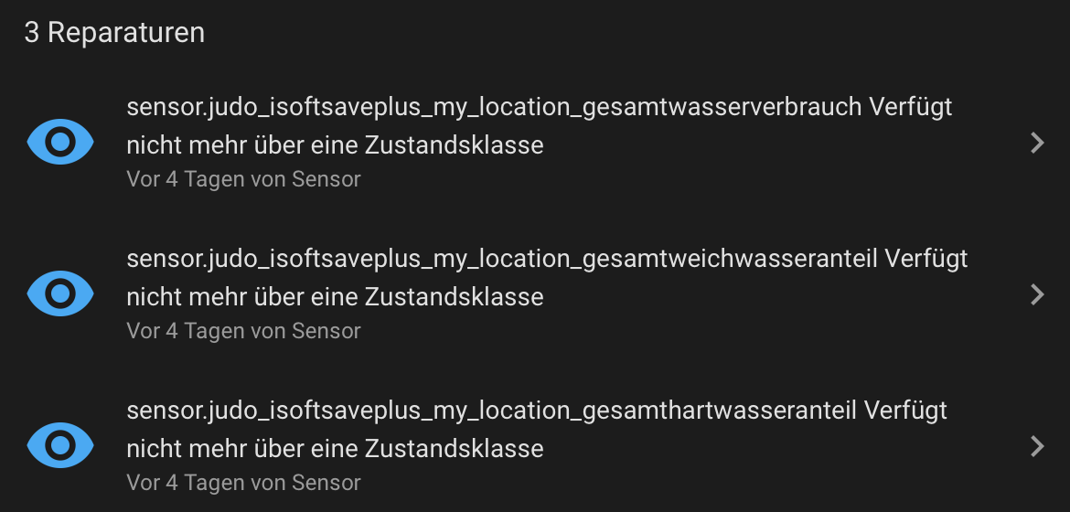

Fist I get a repair prompt everytime I restart hass. Its possible to repair but it keeps coming back.
Second issue: The data from the entity “daily consumption” (or in german: “sensor.judo_isoftsaveplus_my_location_verbrauch_heute”) is getting lost after every restart. 'Unfortunately I can’t edit it to keep the data despite a restart. Curious enough the data that gets collected in the HA energy dashboard is not affected by this.
Is this known and is there any solution to either one of the issues?
Thanks, Frank
