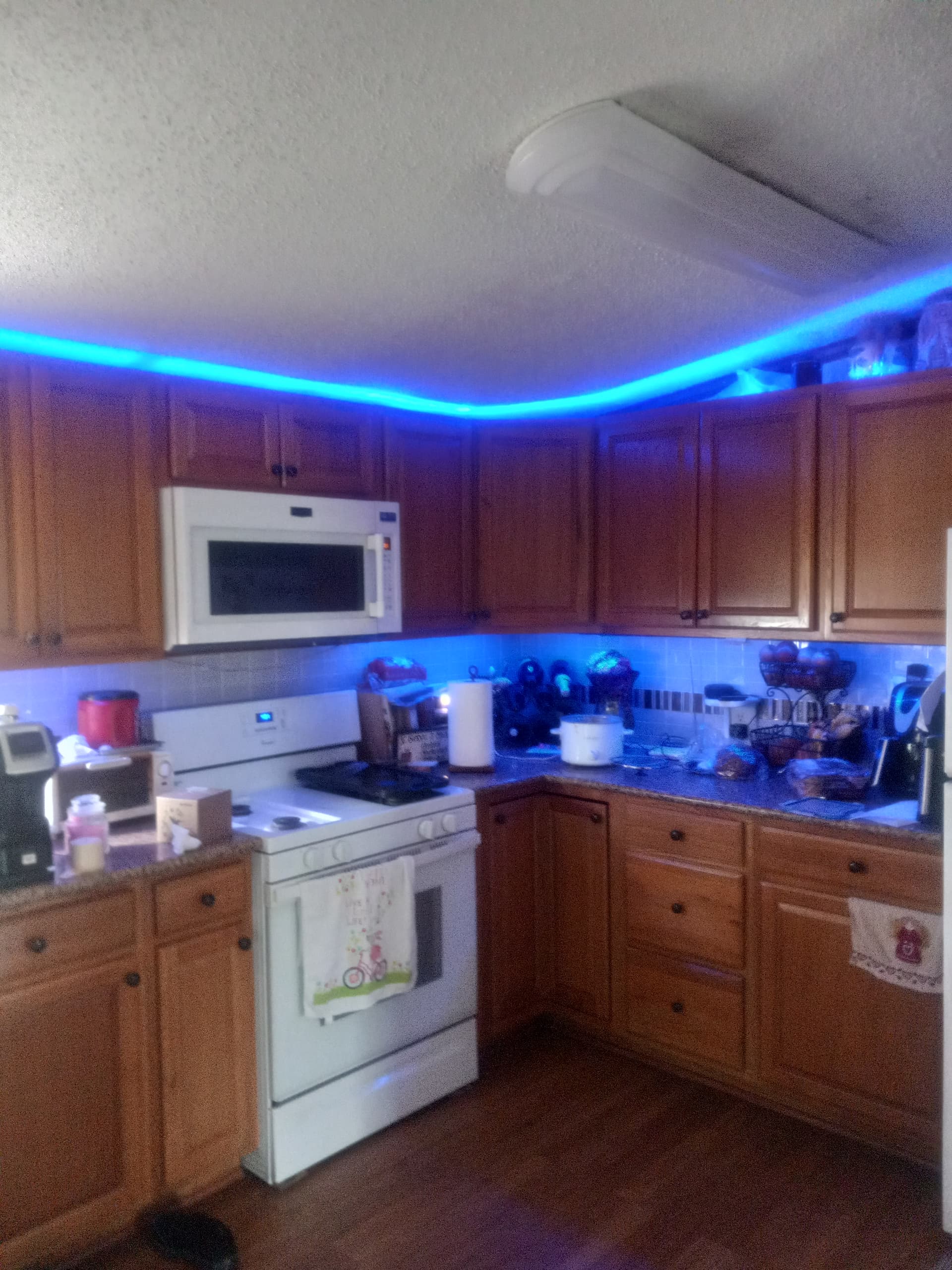

Wanted something to control my under cabinet lights. Put this together. What do you all think? Bad and good comments. Let’s go.
My opinion = Perfection
Esp32c3
Relay
12v buck converter
Old apple airport power supply.
White led strip
Esp home
Esp32c3
Relay
12v buck converter
White led strip
Esp home
What kind of led strip? You dont typically need or should even use a relay for controlling LED’s.
You also need to be mindful of the current requirements whenever choosing a PSU.
Probably would have been easier, cheaper and less components if you had just bought some new addressable led’s. That way youd only need the esp32, 12PSU and thats it!
Also, where the F is the pic of finished project with cabinets lit up?!?! You trying to tease me cupcake??
