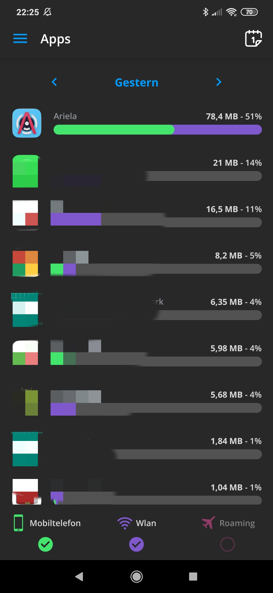

Hello, I am impressed by Ariela and have therefore bought the Pro Version. I use the version on a tablet and also on the mobile phone. I come from “Zanzito” and here I had the location, battery and so on transferred. Always like this up to max 3 MB data usage per day.
Since Ariela I have at least 60 MB to 80 MB per day. This is too much for my data flat if I can’t use W-LAN. (For example ~2.4GB in 30 days) I am currently looking for a solution where I do not receive data from my home control. Except push and only send data.
Can I find a solution without turning off the app? A setting in the APP? Switch to the native web interface?

Those values mostly depends on how much information are passed between HA and Ariela. Note that any event that is sent from HA it will be automatically send to Ariela too.
Can you tell me exactly what are the sensors you are using?

If I understand it correctly. It also means the sensors from HA to Ariela. Here it would be enough for me to get only the current values displayed when I go to the APP. To synchronize all values in realtime is not necessary for me. Here every x minutes would be good. (10 min or 30 min is enough for me) Here is a screenshot (currently growing strongly). About 200 sensors like: Glances, Zigbee2MQTT,… (List all?)
Thanks for the feedback and support. Is it because of the data Ariela sends to HA or HA to Ariela?
screen1
