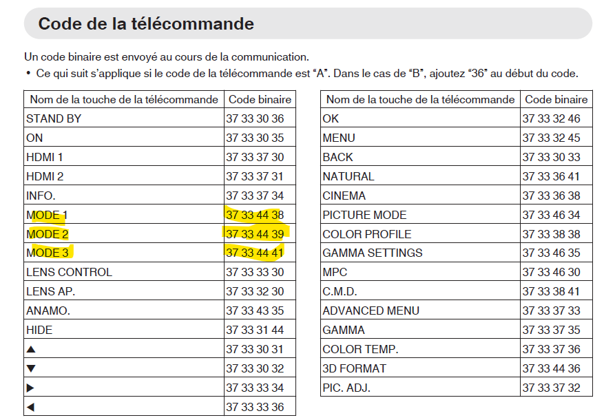

It seems we are missing the ability to send the commands for memorised custom lens modes : Mode1, Mode2, Mode3 available on the physical projector remote control.
Is that possible to add them to the list of commands ?
For info below the extract from the user guide of my projector for the corresponding binary codes to be used:
