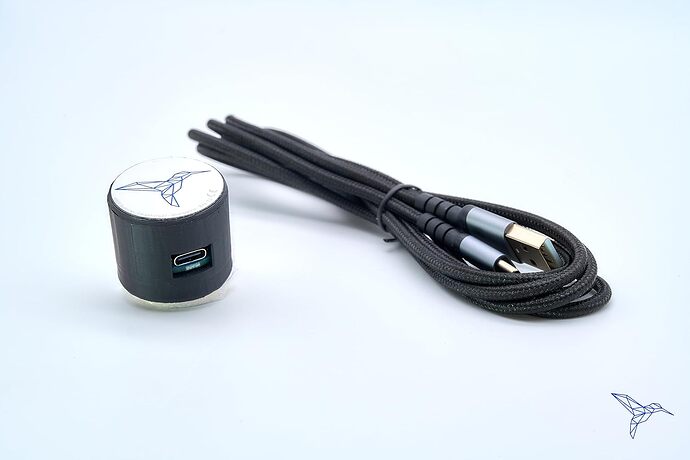

I got it working. Purchased this IR ESP reader and flashed esphome onto it.
The IR was really sensitive, so I had to put tape over the diodes and create smaller holes.
