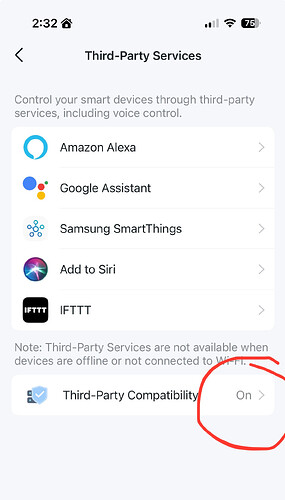

This seemed to work for me:
  1. Install Tapo app (I have no Tapo devices) but the app now supports Kasa devices
  2. Login with TP-Link creds
  3. When asked to link Tapo with Kasa, agree
  4. In the “Me” section, go to “Third-Party Services” and toggle off/on “Third Party Compatibility” like in Jacof881 noted above.
  5. Re-authenticate to Kasa in Home Assistant.

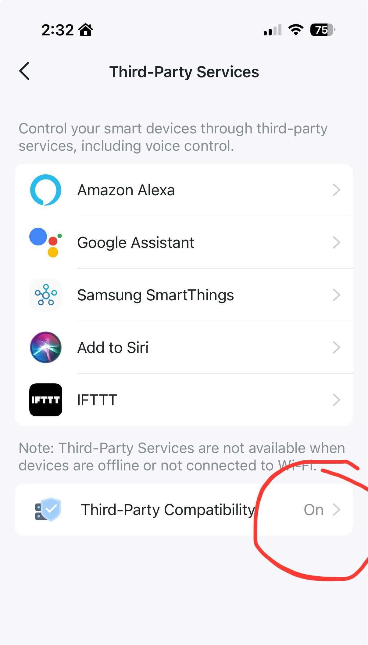

Just got past the problem using BigBHaller’s suggestion, except I did not install Tapo, I used the Kasa app, turning off third party compatibility and then turning it back on my next attempt through Home Assistant a few seconds later was successful.
Simply toggling third party support off for a minute or two and then back on within the Kasa app then reauthenticating in Home Assistant has consistently fixed this for me, for a short period of time, then it expires again.

Found a thread on the TP-Link forums discussing this issue, this solution worked for me.
TLDR:
Ignore discovery. Make sure you have 3rd Party Integrations enabled.
Grab the device IP (discovery should be giving you the correct IP, else you can grab it from the Tapo app. Kasa app doesn’t seem to have device IP listed).
Then go to the TP-Link integration and manually Add Device, give it the IP of the device. It should instantly add the device without providing credentials.
