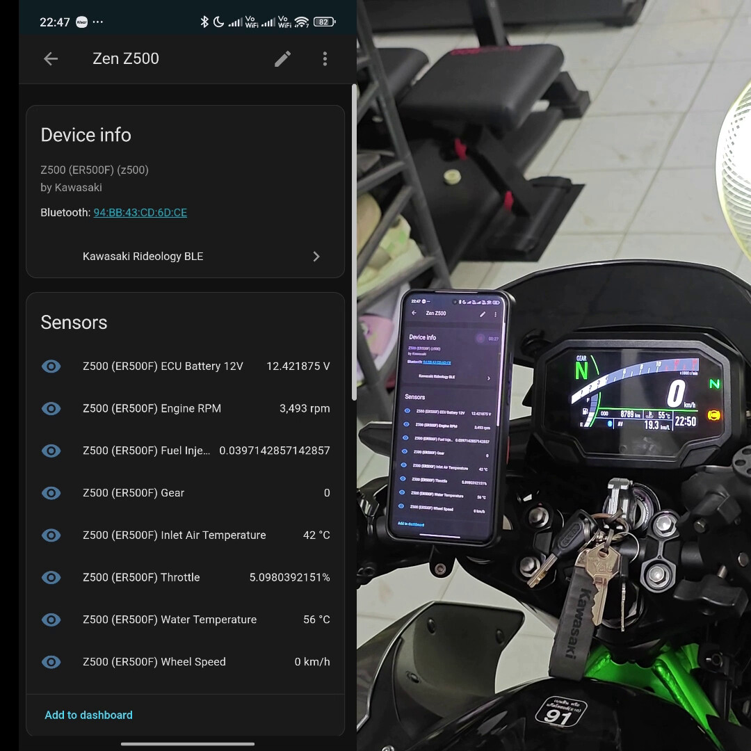

Hi everyone. After releasing my recent DJTPMS integration, I thought, my motorcycle also uses Bluetooth, so why not connect it to Home Assistant too?
That quickly put me in very niche territory. Plenty of people ride motorcycles, but far fewer ride a Kawasaki and also use Home Assistant. I also could not find any BLE protocol documentation for my bike.
So I spent two weekends sniffing, reverse engineering, and building this integration. I hope others in this niche will enjoy it too. :slight_smile:

Kawasaki Rideology BLE
A Home Assistant custom integration that connects to Kawasaki motorcycles over Rideology BLE to expose telemetry and status sensors.
