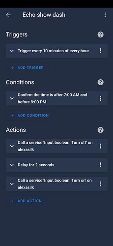

Not sure need the delay and volume part but this is my exact routine and automation
Mine looks the same but does not trigger.
