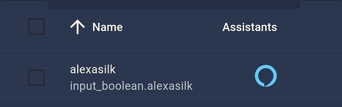

  1. To make the Alexa routine run every 19 minutes you need an external trigger. I created a ha switch, input_boolean.silk for example that you can then discover in alexa. Either nabu casa or other worka arounds like emulated hue.

I managed to setup the boolean, create the automation, discovered boolean it in Alexa, but get stuck in setting up the routine.
I’m not able to find in WHEN: “alexasilk opens”. I can only select from a predefined list that the routine wizard gives me.
Any thoughts?
Alexasiilk is just what I called it. Did you expose it in ha to skexa? Did alexa discover it.? The on routine when - smart home- choose alexasilk
Yes I also called it alexasilk in HA. Alexa discovered the boolean and the toggle in Alexa interacts with the toggle of input_boolean.alexasilk, so that all seems to work fine. But then setting up the routine in Alexa, how did you do it?
Thanks @Littlejoe so the problem is, I don’t see alexasilk as an option when selecting SMART HOMEm, like you do. Is there anything specific I need to select for the alexasilk HELPER in HA in order to make sure that Alexa discovers it in the right way?
Do you use naba casa? If not then you’ll have to use a workaround that more complex. They are mentioned here. Home assistant and Alexa without Nabu Casa (and AWS if possible) One uses node red and a 3rd party persons site. The other uses alexa skills. I just paid for nabu casa. For the voice assistant integration. Sorry
