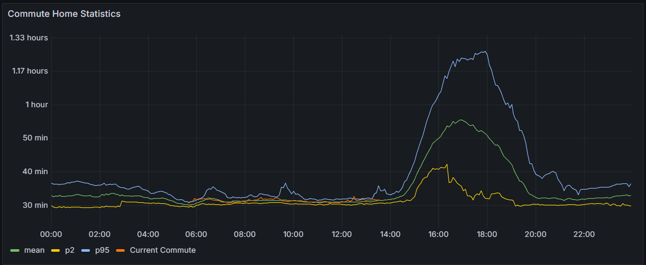

Wow this is really awesome! I am trying to figure out how to do something that seems similar and wanted to see if you think this is could be a good starting point.
I am trying to take the commute time from the Waze navigation integration and for each recorded value store it with a time of day value so that I can look up all data points that occurred during each 5 minute bin throughout the day. Then I can run statistics on it like Standard deviation and mean to calculate the 95% commute time for each 5 minute increment. Would love to hear your thoughts!
Thanks for sharing such an awesome macro!!
You’re welcome. It was fun to build. It is used to start the heating in the morning at my house.
Wow, what you have in mind can produce a lot of data. It is one thing to have 7 days, but there are a lot more 5 min intervals. You might run in to the limits of what attributes can handle efficiently. Note that I basically rebuild the data structure with each update. So you should definitely exclude this entity from the recorder. I think I’d see if there is a better way to manipulate that much data.
Ah I see. Yeah I have a reasonably powerful VM with relatively unlimited storage so what I was hoping to do is just store each point and run the statistics each night at midnight or something. Right now I send all the data into influxDB and then create a plot in grafana with the mean, 95%, 2% and current commute lines. This kinda works but each time I refresh the graph it has to run the complete query again which is a decent load on my server for like 10 seconds or so. Also I wanted to share this grafana page with my Team at work and if everyone was using it it would lead to a ton of unnecessary load on my VM.
I guess for now I need to keep looking. Probably start a discussion to see if any has any real good suggestions. Here is the current result for reference.
