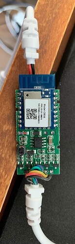

Device is a BK7231N-QFN32 with a CB3S Wifi chip.
I was successful at using the iH001 single color LED profile in cloudcutter to reflash my device with LibreTiny, but of course, I lost all the controls and RGB features. Through trial and error, I was able to map all of the pins back to their correct LEDs. Here’s my yaml in case others wind up with this same unit:

Adding here another variant of Tuya with cbu board.
It’s just an RGB, not W.
Thanks to @t3d, I was able to use his template with some changes.
This device also has a mic and a music mode, but I could not find anything with such an option to enable this in YAML.
I’ve manually tested the RBG pins by dragging the colour picker into the corresponding colour pan.
