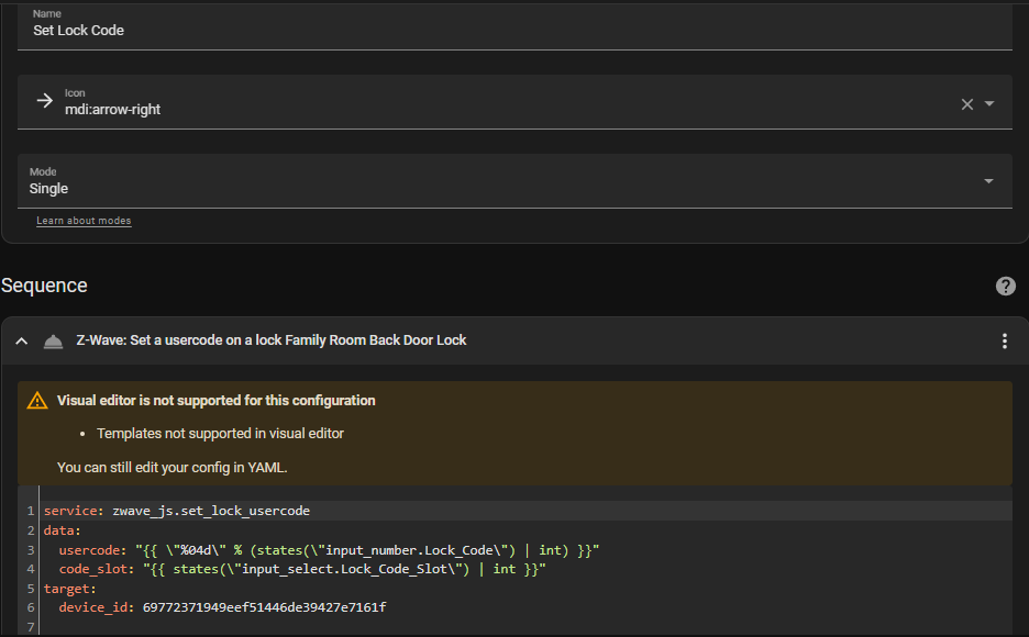

With the help of various forum posts, I was able to cludge together as simplified way to do this.
Here is my Dashboard card to control it:
type: entities
entities:
  - entity: input_select.lock_code_slot
  - entity: input_number.lock_code
  - entity: script.set_lock_code
  - entity: script.delete_lock_code
title: Back Door Lock Codes
where,
input_select.lock_code_slot is a drop down helper:
input_number.lock_code is a number helper:
script.set_lock_code is:
script.delete_lock_code:
You’ll have to edit those scripts according to your lock details, but hopefully this can point you in the right direction!

I am new to creating scripts and can’t figure out how to get it created like how you show. If I try and type it manually as yaml in services, it complains about the syntax.
