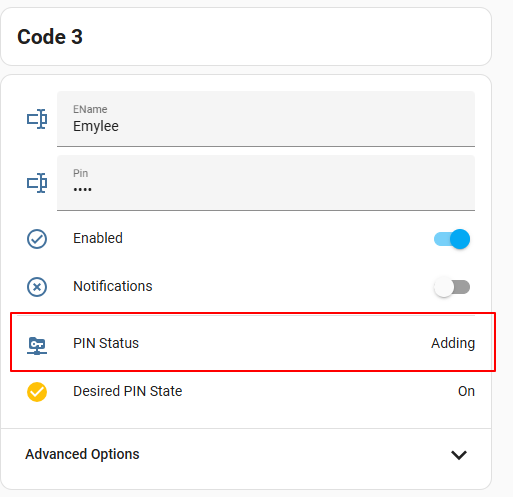

I installed Keymaster today. All went well. I was able to add a code to Code #8. It worked. I then added to Code #1 and #2. All good there. When I add to code #3, the status says at adding. When I click the Enable off, it stays at Deleting status. Anyone have any ideas?
Adding

On the code that is stuck on adding or deleting, go to key master and turn off ā€˜enable’. Then go to developer’s tool, just above settings on the left navigation bar. In Developers tools select actions → then enter in the action box ā€˜Z-Wave: Clear lock user code’ → then in Targets select chose device → select your lock → in code slot enter the code slot that was stuck at adding → then select perform action
Give it a minute then go back to KeyMaster and enable the slot again. You may have to repeat.

Thank you, that seemed to work for now.
