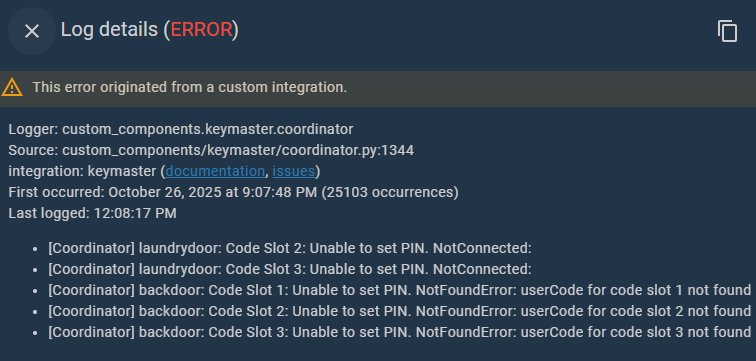

Hi All,
I noticed yesterday that my Keymaster addon was broken which I figured was due to a recent HA update (not sure when exactly this happened but come to think of it I have not been getting notifications for a while). I removed the addon and any residual files then did a reinstall with v0.1.0. I have Keymaster working with my 4 Schlage BE469ZP locks using my front door lock as the parent. I setup 3 codes which have synced to the front door but I they are not syncing to the other 3 locks, it shows some codes as synced and the others as “adding” Below is one of the errors I am seeing in the log
The other thing I noticed is that I cannot set the auto lock timers for day & night, the option shows in the lovelace view but the auto lock entity is unavailable.
I did some research and there have been some problems with Keymaster being broken, my question is should I be using the latest beta as there still seems to be a problem with v0.1.0
Thanks in advance
The current beta version (v0.1.1-b0) has fixes related to hidden PINs. Do you have the Hide PINs in UI option set on any of the locks in question? If so, then you need to pick-up the latest beta. Also, since you mention Schlage and those locks tend to hide the PINs at the zwave level, you probably do need to pickup the beta.
Hi Andrew,
Thanks for the reply. I did somer further troubleshooting with v0.1.0 last night, I removed Keymaster then re installed it but this time I did not use my Front door lock as the parent, I setup each of the 4 locks independently. I do not use the hidden pin option, what I found now is that my front door, laundry door & back door take pins properly and show the synced status properly. My garage door however just shows either adding or deleting and never changes to synced. The code I did put into slot 1 has made it too the garage door though. The only other thing with this version is I cannot set the auto lock day & night timers from the Lovelace view but I found a work around for that.
I can try the latest beta tonight
OK I think I may have found what the problem is, I could not even clear any of the codes on my garage door using the developer tools option plus I was seeing a ton of errors in the Z-Wave JS log so I excluded this lock and then re added it. Now I can manually add/delete codes using the developer tools so I will re install Keymaster in the morning.
I will report back then
