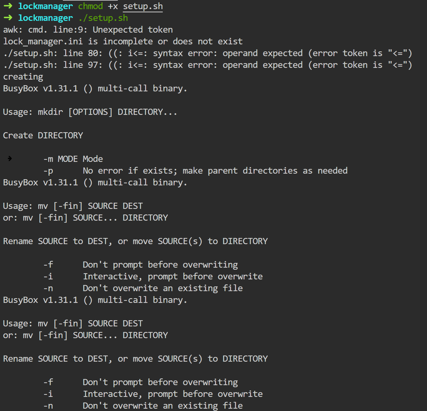

Same issue here.
awk: line 9: syntax error at or near [
awk: line 10: syntax error at or near [
awk: line 11: syntax error at or near else
awk: line 12: syntax error at or near [
awk: line 16: syntax error at or near [
lock_manager.ini is incomplete or does not exist
./setup.sh: line 80: ((: i<=: syntax error: operand expected (error token is “<=”)
./setup.sh: line 97: ((: i<=: syntax error: operand expected (error token is “<=”)
creating
mkdir: missing operand
Try ‘mkdir --help’ for more information.
mv: missing destination file operand after ‘*.yaml’
Try ‘mv --help’ for more information.
mv: missing destination file operand after ‘_lovelace’
I can gladly give you access to the config if you want to try it.
Here is where I fail:
when I run the setup.sh no new folder generate as the github instructions state would.
I am only trying to setup one lock, here is the ini:

For those who are having problems running setup.sh it looks like you need to be using gawk (tested with 4.2.1, may work with older) but mawk from Ubuntu and nawk in FreeBSD certainly don’t work without some modification of the code.
It does run under Ubuntu if you install gawk and it works in FreeBSD if you install gawk and gsed and patch the code to run those versions.
Unfortunately I have no clue what any of that means. I am running home assistant in a virtual box on my windows pc. Any suggestions on how I go about running this?
Are you running Windows 10? You have a couple options, you could install Ubuntu in another VM and install gawk (sudo apt install gawk) or possibly use the WSL (Windows Subsystem for Linux) and do the same thing. Other than that I don’t have anything just yet.
There could probably be a way to patch the code to know that it is using a different awk (busybox for example in what was hassio) but I haven’t had the time to look into it yet as I just stumbled on this myself and tried to get it working.
I appreciate the help on this. I may attempt the option you suggest if I have time down the line.
Do you have an alternate method of managing locks and users you can suggest for me? I cannot seem to find anything that works for me. currently I can only lock and unlock my system and I have yet to figure out how I can add users and pins, etc. I was hoping this would be my solution. I will likely connect it back to my SmartThings Hub for now and go that route until I find a better option. If you cannot tell I am new to Home Assistant (within the past month).
^this is the answer
@FutureTense - Great work bro. Quick question, can you maybe get the Status Report Sensor to use the input_text.<your_value__name_1, name_2, etc when updating. That way we’d get the name of the code that was used. And maybe same with the notification delivery…so I know which kid just passed through the frontdoor. Cheers!
Ok…So I also have no idea what gawk is…can it be used with a HassIO install?
HassIO (Home Assistant) uses alpine linux as a base. Give the command apk add awk or apk add gawk a try from a shell.
dude that worked! At least it installed, haven’t fiddled yet, but adding gawk as you just said (apk add gawk) through the terminal and then running ./setup worked! I will report back if I end up being wrong cause I cannot fiddle with it until later.
