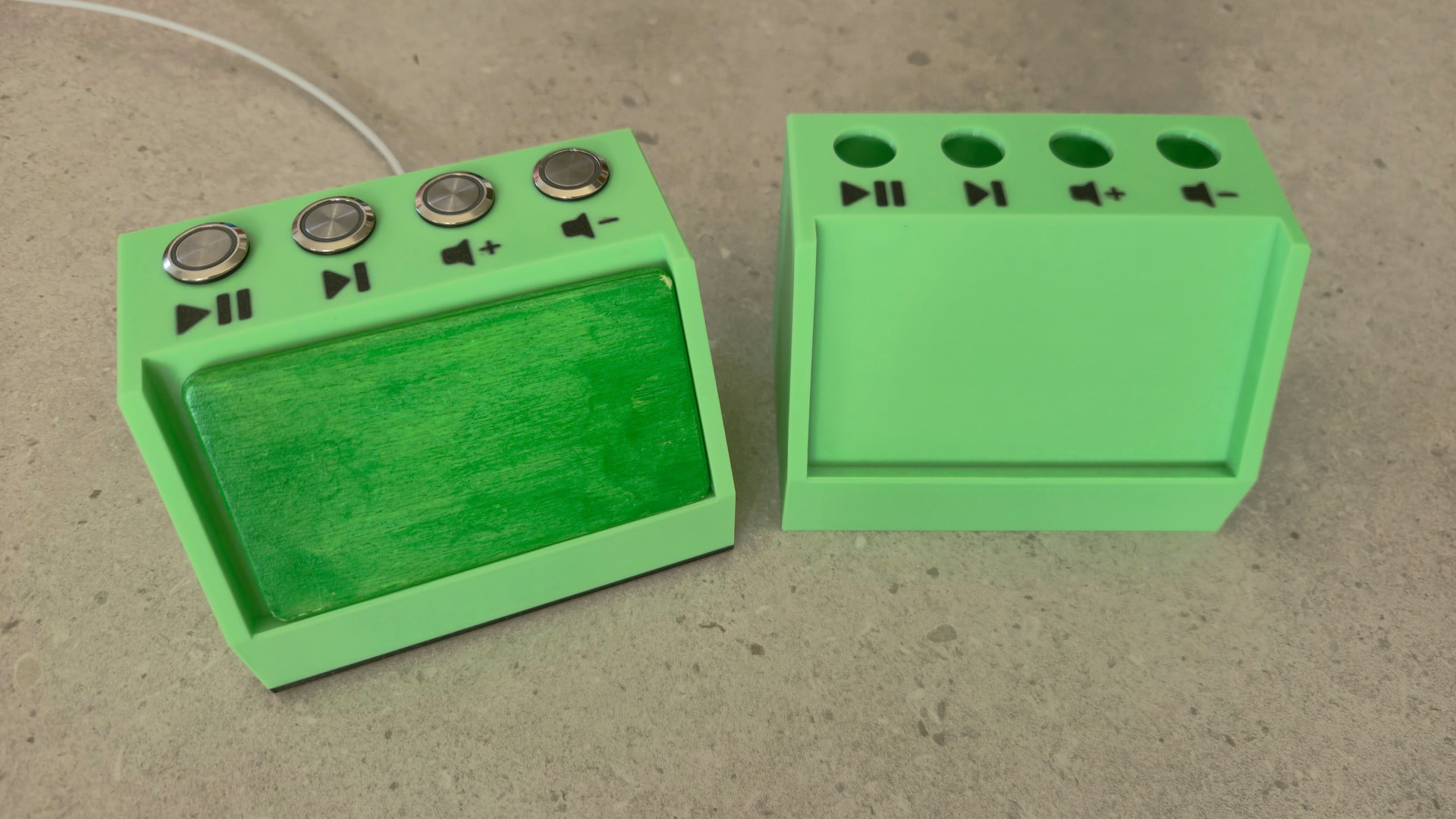

KidJuke the alternative to Faba/Toniebox/Yoto in Home Assistant
Hi everyone!
Meet KidJuke, the fun and open alternative to Faba, Toniebox, or Yoto for your Home Assistant setup! Here’s the magic: ESPHome handles the hardware, a Home Assistant blueprint powers the automation, and Music Assistant takes care of the tunes.
With KidJuke, kids can easily control their music—play, pause, skip tracks, and adjust volume—plus pick what to listen to (playlists, albums, radio, artists) using RFID cards. I’ve detailed the build process in this post.
Features
  • Map RFID cards to specific music
  • Set minimum and maximum allowed volume
  • Define volume step increments
  • Set a default behavior for simple mappings
  • Add an input_boolean to completely lock commands (perfect for bedtime!)
  • Choose whether to enable random playback by default
  • Set a delay between button commands
  • Select which media player to control
Requirements
  • Hardware: A KidJuke (or compatible switches work too!)
  • Integration: Music Assistant
  • Other entities: You’ll need an input_boolean not provided by ESPHome; a helper like a complete device lock works perfectly.
Instructions
  1. Install a KidJuke in ESPHome
  2. Integrate the KidJuke into Home Assistant
  3. Create an input_boolean helper for the lock function
  4. Confirm that Music Assistant is active
  5. Install the blueprint and create an automation based on it
  6. Happy listening!
