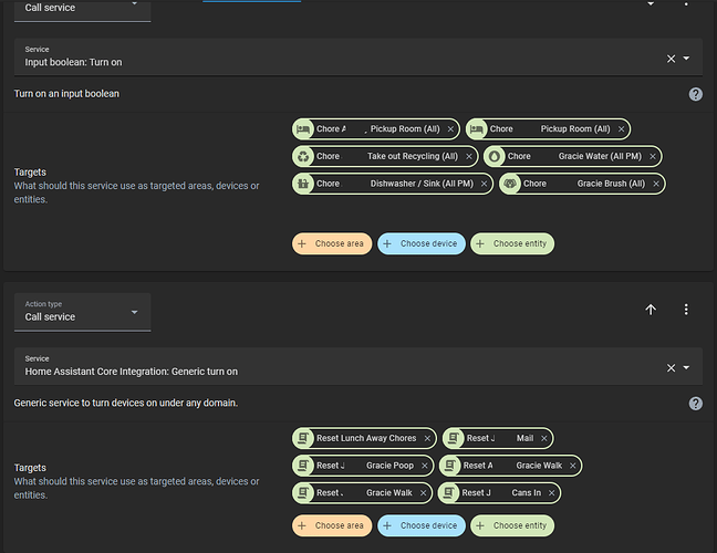

The ‘reset’ automations run at midnight and 2pm each day. These turn ON the input_booleans for the chores needing to be done. Example of the Reset at 2pm automation:
Chores that run EVERYday use the input_boolean.turn_on (top portion), where as chores only on some days each of these has its own script written to skip turning them on various days (bottom portion). Example, our trash comes on Tues/Fri, so here’s that script:

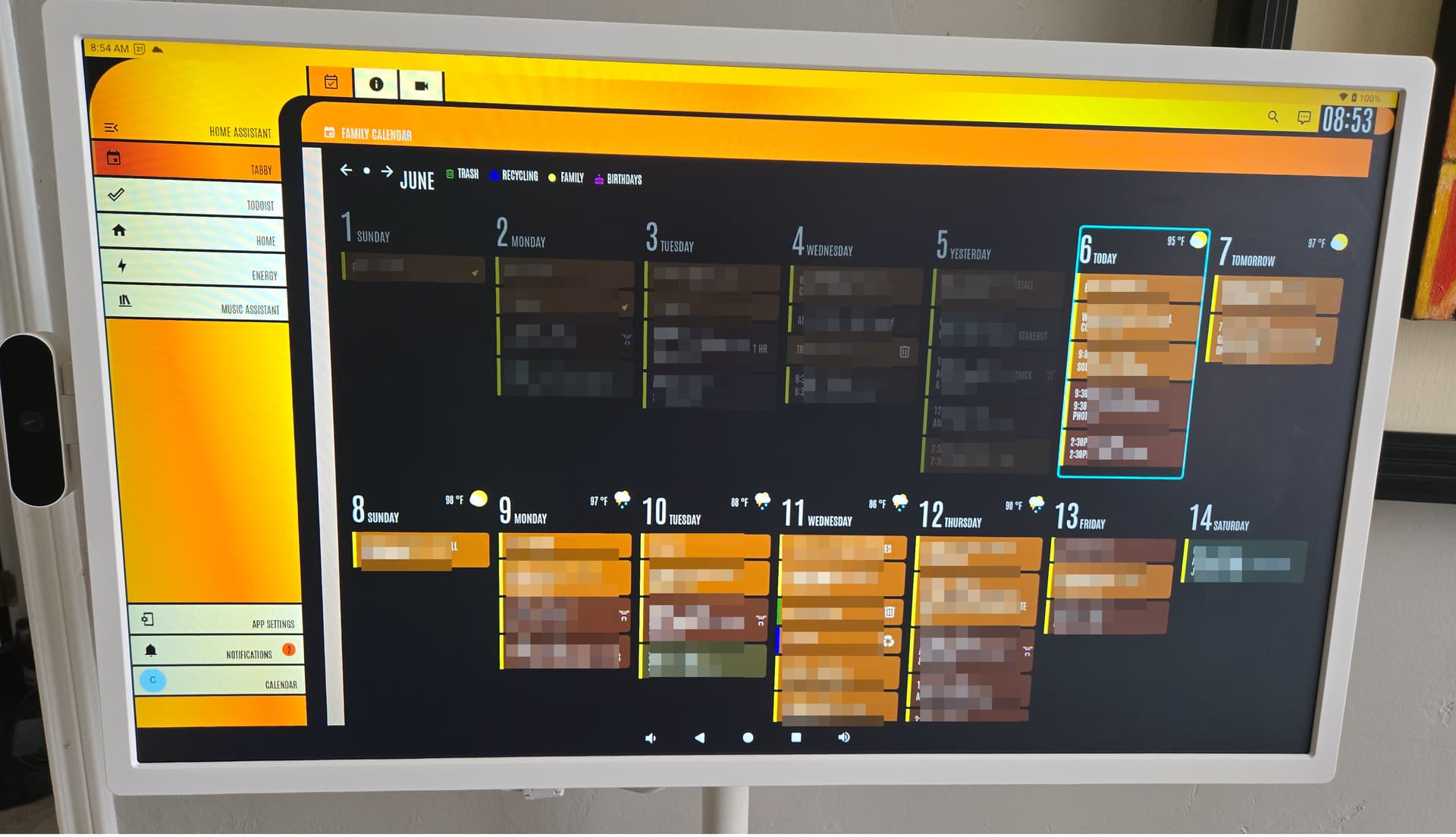

Instead of casting, though, I found a 32" android tablet (Coyzla is the brand) with a battery on a rolling stand and we now have a “family stand-up” at dinner every night…suddenly the whole family is on board with Home Assistant. The tablet runs HA natively; I made a user for it and default to the family calendar.

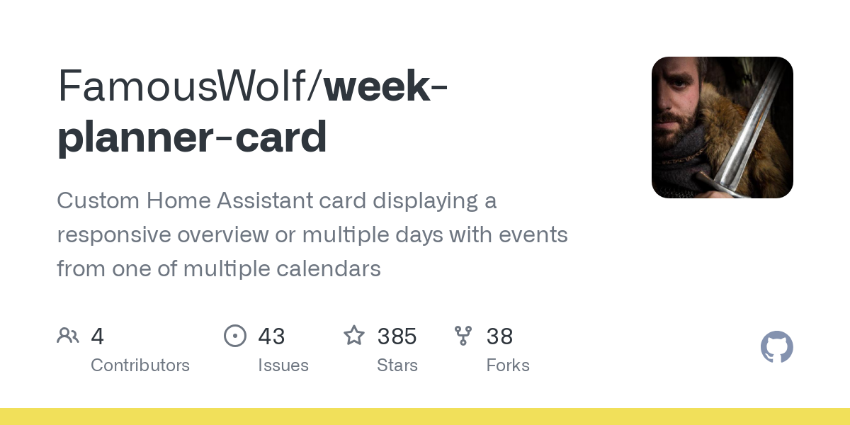

I’m using week planner card:

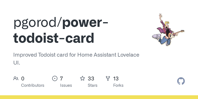

and PowerTodoist with ToDo lists filtered for each family member:
and the LCARs theme:
