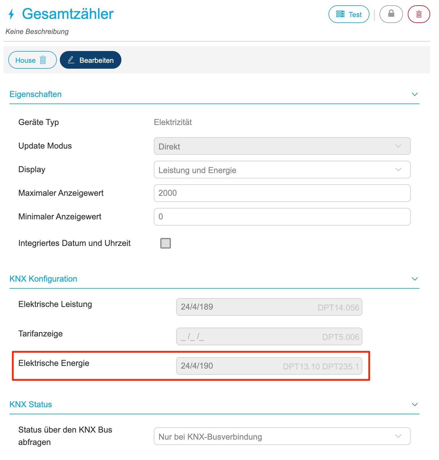

I ran into the exact same issue with my Hager TE331 but I managed to implement a workaround.

  - address:
    - "24/4/190" # Gesamtzähler (Elektrische Energie)
