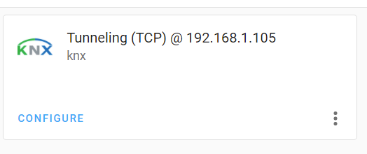

I tried setting the Tunneling to TCP, and it seem to work? (Atleast no errors).
