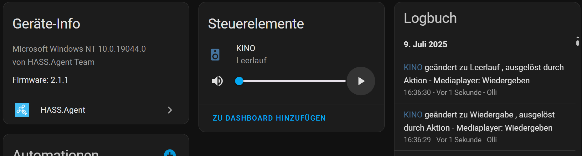

I stumbled across your posts when I was looking for the solution to my MPC-HC, Kodi and Home Assistant problem.
Now it works with the “hass.agent.integration” unfortunately only partially. Partially because the play/pause button jumps back within a second of pressing it.
I have searched everything and tried many things, but unfortunately nothing changes. Maybe one of you has the crucial hint for me to solve this problem :slight_smile:

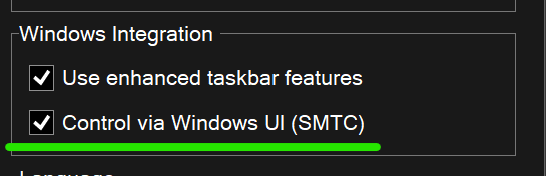

Do you have Control via Windows UI enabled in the MPC-HC settings?

I cannot find the item “Windows Integration” in my settings.
One point of this is available:
“Use enhanced taskbar features”.

I found a newer version of MPC-HC (2.5.0) and now the
“Windows Integration” is ON,
but nothing change :frowning:
I don’t know what it was, but I restarted MPC-HC and now it works, even the movie cover is displayed in HA.
Thank you very much for your help, I would never have thought of it on my own, THANK YOU :slight_smile:
