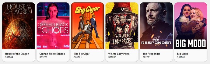

Sure. I have Pyscipt installed, and wrote the following script, kodi_tv.py, based on one I found online …

I then have an HA script that runs the kodi_tv_update service, which is set to fire every afternoon to update the info…
alias: Kodi TV
sequence:
- service: pyscript.kodi_tv_update
data: {}
icon: mdi:language-python
mode: single
The data appears in a sensor like so…
To get the interface, I am using layout-card, card_mod and Mushroom UI.
type: custom:layout-card
layout_type: custom:horizontal-layout

And finally, to make the buttons play the TV shows when you tap them, I wrote an HA script like this…
alias: Kodi Play TV File
sequence:
- service: kodi.call_method
metadata: {}
method: Player.Open
item:
file: "{{ state_attr('pyscript.kodi_tv', ('file_' + index|string) )|string }}"
entity_id: media_player.192_168_0_200
mode: single
icon: mdi:kodi
So, yeah… it’s a bit fiddly… but it works rather well. I also had to modify a few of the other elements to get the same functionality for movies, but that was a bit easier, as I didn’t have to roll my own sensor!
Oh… and don’t forget to set the IP in the scripts to that of your own KODI server!
Good luck! ![:smiling_face_with_three_hearts: :smiling_face_with_three_hearts:](https://community.home-assistant.io/images/emoji/twitter/smiling_face_with_three_hearts.png?v=12)
