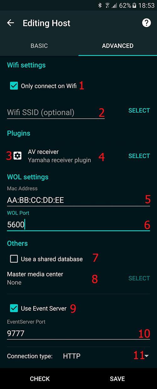

I can’t get the WOL on my kodi working? Along with HA, I use Yatse remote control. Wol works with Yatse just fine, but I want it to work in HA too. I have Kodi working on an Androidbox. In the Yatse configuration I have to add a WOL port number, so a launcher on my Android device can startup Kodi on the same device.
Example off Yatse

I have added the Wake on LAN component on my configuration.yaml, and added port number 5600 on the datafield to turn_on_action. I could be that this option isn’t available in the components/media_player/kodi.py.
