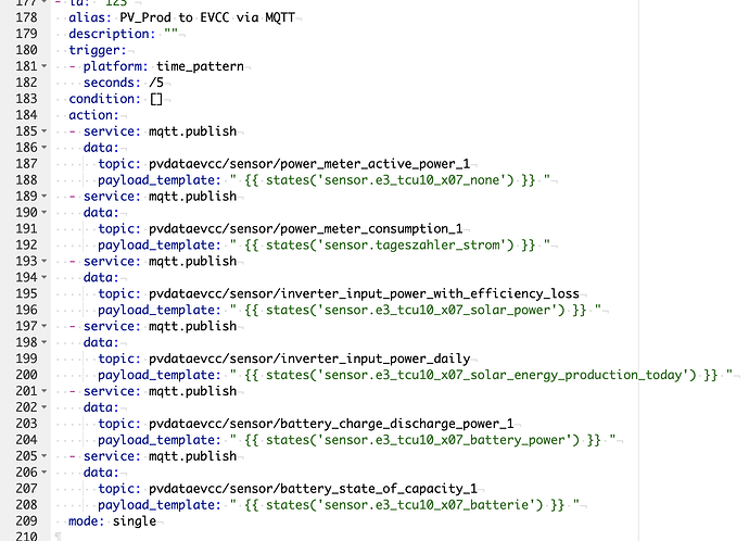

[image]
Hi everyone, one question I have some trouble with my Configuration. You can see I get the actual status from grid and from Son. But no solar power and the Battery charge and discharge are detected exactly the wrong way round. Can you see where I have do the mistake ?
