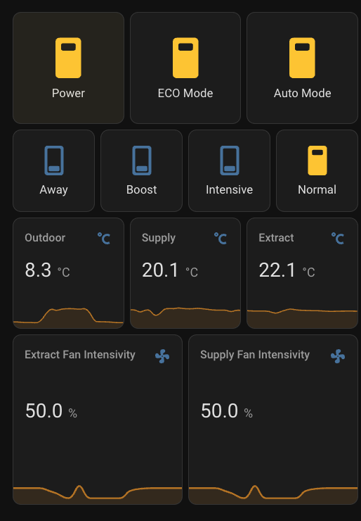

This is my current C8 setup, I can share the full config when ready if anyone is interested.

I’ve created this configuration for my Komfovent C8 , works like a charm!
