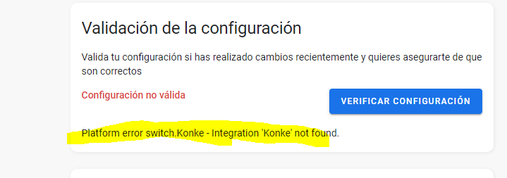

When I try to validate the system config in order to restar I have the error:
Platform error switch.konke - Integration ‘konke’ not found.
If someone can give me a hint to solve it it’s really appreciated :slight_smile:
Thanks in advance to all.
I just set this up myself after getting a deal on some compatible elf smart plugs on newegg.
The error you see happens because the custom component has not loaded yet. So, while the error is correct, you should be safe to restart homeassistant. Upon restart, the konke custom component should load. It works fine for me.
Thanks so much for your response! I haven’t good luck. Same issue for me.
Look, I attach photo for you… anyway I think I will not use this device :frowning:
