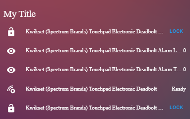

Hello, I am having trouble getting the Battery Status, Lock status and lock switch
zwave.kwikset_touchpad_electronic_deadbolt
ready
node_id: 10 node_name: Kwikset Touchpad Electronic Deadbolt manufacturer_name: Kwikset product_name: Touchpad Electronic Deadbolt query_stage: Complete is_awake: true is_ready: true is_failed: false is_info_received: true max_baud_rate: 40000 is_zwave_plus: false capabilities: frequent,beaming,routing neighbors: 1,5,6,7,8,11,26 sentCnt: 10 sentFailed: 0 retries: 0 receivedCnt: 7 receivedDups: 0 receivedUnsolicited: 0 sentTS: 2019-04-03 09:42:50:597 receivedTS: 2019-04-03 09:42:53:210 lastRequestRTT: 2586 averageRequestRTT: 2370 lastResponseRTT: 2614 averageResponseRTT: 1747 battery_level: 70 friendly_name: Kwikset Touchpad Electronic Deadbolt
I know that HA knows the status I just can’t get it to show on a card, in entities all I see is the lock and alarms…
any assistance is appreciated.
Chas

Hello All,
Well a year has passed and over that time the locks have quit responding to home assistant.
And the Battery shows up but with no information.
I have removed the nodes and re-added them, the entities show up 4 for each Lock.
But I can’t seem to get them to respond. Originally they were Node 37.38.39 now they are 100,101,102
I am running Unraid on a Dell 710 using a Zooz Zst10 S@ Z-wave Plus USB Stick.
Any and all suggestions and help will be appreciated.
Chas

For anyone else having this issue.
My original config.yaml had the Network Key commented out, I have no idea why I had done that but I am confident that I did.
to get these lock working I needed to reverse that so that the network key was active, then remove all three nodes and include them once again.
once that was complete I went from having 3 entities per node to 5 entities per node, with the Battery percentage working and the locks responding.
Just an FYI
