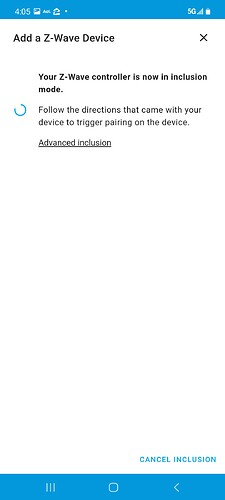

I made my server mobile again last night and tried pairing it again but this time with the Zooz stick touching the door lock as I was trying to pair it and still no luck. I tried it multiple times, and on other locks and still nothing.
I also tried forcing s0 inclusion as suggested with the same results.
I did a factory reset on the lock as outlined in the 910 manuals which is also what is listed in Z-Wave JS Config DB Browser entry before trying to pair the locks. I would have tried doing the exclusion through the controller but the old OpenHAB server is inoperable.
At this point I have a Raspberry Pi 3 that isn’t being used. I’m thinking of installing HA on it, plugging in the old Aeotec stick to see if I can’t get that to pair just to try and rule out the difference in hardware. If that works I’ll exclude everything and reinclude them using the Aeotec stick.
