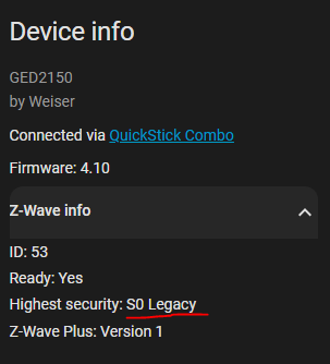

Hi all - I hope this helps some of you out there with the Kwikset / Weiser SmartCode 10 Door Lock and Z-Wave inclusion with Home Assistant. My touchscreen deadbolt was working fine for years with HA, but when it was removed/re-added I found it did not expose the same functionality. It seems Z-Wave JS favours unencrypted pairing for some reason (Even though you specify it!) AND does not seem to properly interview the device. Successful unencrypted inclusion DOES NOT expose any of the unlock/lock entities you want when pairing with HA). You need to ensure that the device is pairing with S0 Legacy encryption or higher! (as shown in the successfully paired device info below):

  3. Ensure to Pair using S0_Legacy - unencrypted will not expose UNLOCK/LOCK features after interview!

  6. Stop Z-Wave JS UI after about 5 minutes (waiting until values/interviews are completed), and then start Z-Wave JS back again. Verify that the highest security protocol is S0_Legacy or higher & allow for for ~3-5 minutes for values to refresh!
