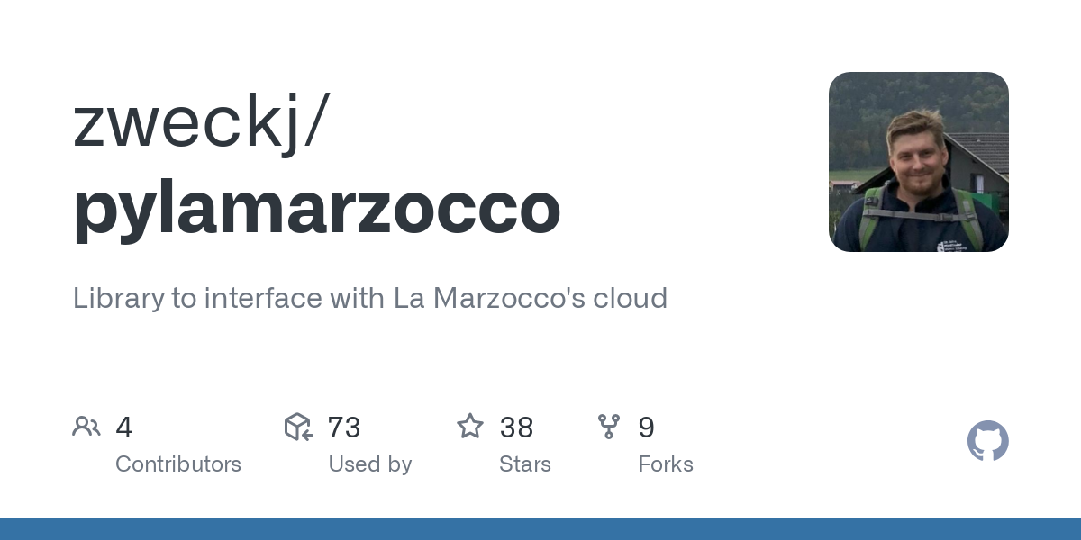

Assuming by mentioning pylamarzocco, you are referring to this:
The developer has submitted a pull request to update the current La Marzocco Integration with the new pylamarzocco v2 which they have been working on to fix the issues with the v5.0 firmware and the fact that La Marzocco shut down the API which the integration used to rely upon.
