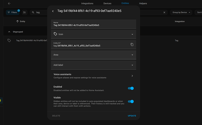

You can go to the entities page and filter by tag. This will allow you to only show your tags and assign (bulk or single) labels to each tag in your entity list:

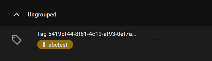

After adding labels:
okay, that already is nice to know, thank you!
so tags can have labels, we are just missing the UI in the tag editor, then. the automation part is where is gets tricky, because there is no UI either.
for the moment, it just seems to be possible, to use a specifig tag scanned as a trigger. i probably can do some template magic, to check the label of said tag, but in the UI, setting a tag with a specific label as trigger seems to be not possible.
