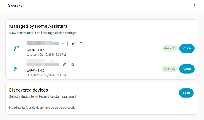

The integration adds a dedicated sidebar panel for managing Lafaer LWR01 and LWR02 sensors, including:
  • Device management: Discover, take over, add notes, edit device details, and remove devices from the list.

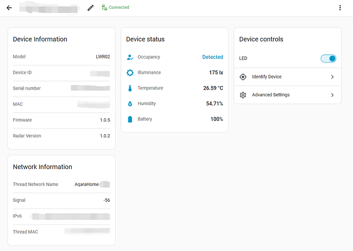

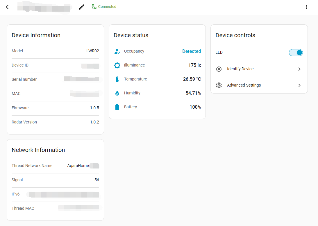

  • Sensor readings: View presence, illuminance, battery level, and device information. LWR02 also supports temperature and humidity readings, while LWR01 reports its power source.

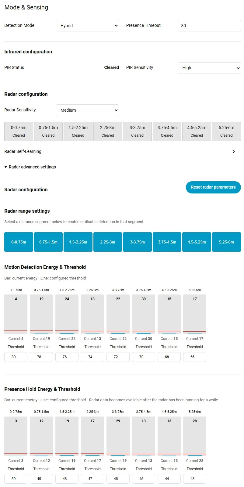

  • Detection settings: Sensitivity, presence timeout, and low-light reporting.
  • Advanced radar configuration: Configure radar distance segments and energy thresholds, toggle high-performance mode on LWR01, and view live energy readings and charts on LWR02.
  • Device controls: Control the LED, identify the device, run radar self-learning, and reset radar parameters.
