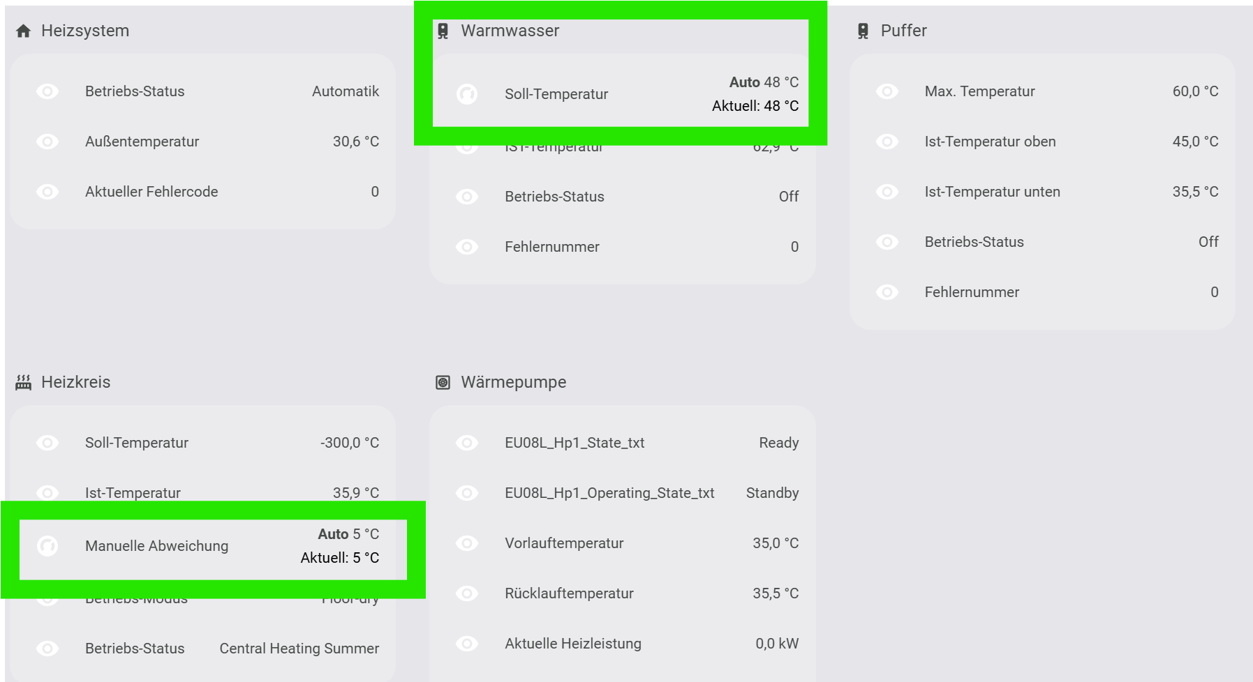

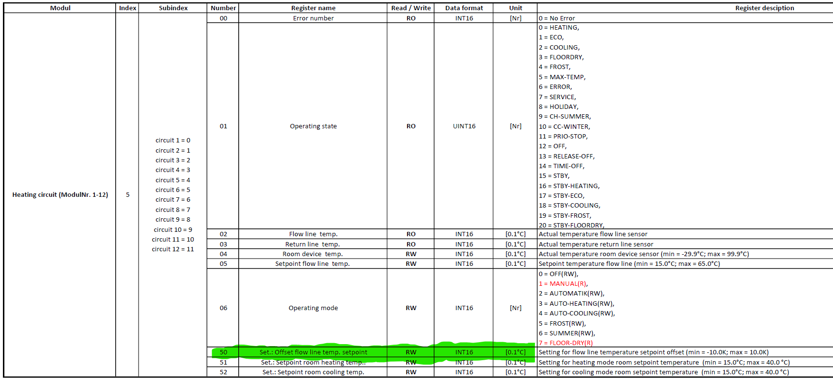

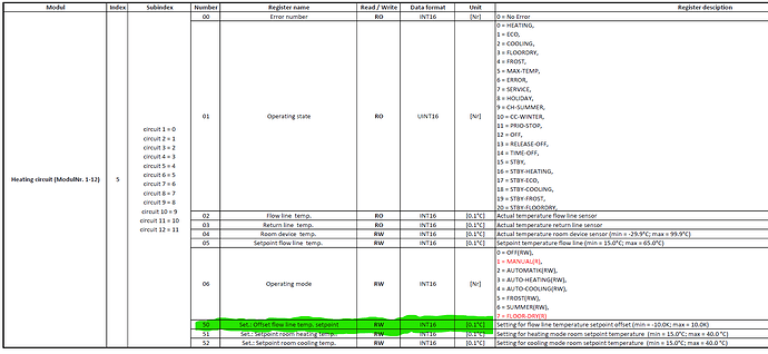

Hi, can I also write with this integration to the Lambda via Modbus? There are some Sensors that allow this according to the documentation. I’d like to write the Offset Temperature for the Heating Circuit, if there is a lot of Solar power and possibly the Operation State.

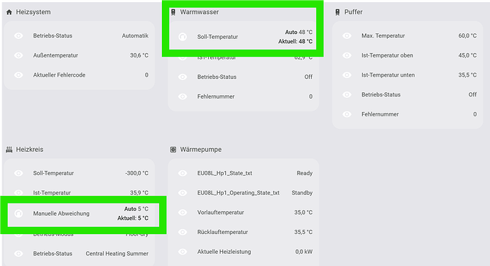

Well for now I ended up using this setup floriansProjects/lambda-heatpump-homeassistant: Dokumentation der Integration einer Lambda/Zewotherm Wärmepumpe per Modbus (TCP) in Homeassistant. I expanded it and now I can controll the Heat Ciurcuit offset temperature and the warm water boiler temperature via a “climate” control. When there ist a lot of energy from solar, I can now increase the hotwater temperature or the temperature of the heating dynamically. It would be nice, if someone found a possibility to make a swich to turn on/off the heating circuit via home-assistant.
Why do you use a manual override for water temperature? You can use Home Assistant to feed your PV power into the heatpump and it will do all that automatically.
I have a thermal solar plant on my roof and on sunny days i want to prevent the heatpump from making the water. Since it is not possible to switch the Boiler “off” via Modbus, I change the Water Temperature to only 25°.
