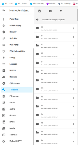

If I uninstall both VSC and GitHub, can I just delete the data/.git files?
How do I get to the data/.git files?

This is my understanding… The git files are a pull from your repository and you can safely delete them from your local disk. Delete the integratoin or the next time you start Home Assistant, the integration will just do another pull.
Do a full backup first.
