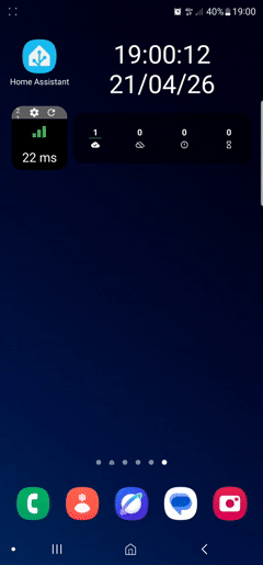

You can see it on the screen capture animation below.
HA_Loading
After closing the app manually (with the task manager) and reloading, I get the Unable to connect to Home Assistant error and I have to tap 2 times on Retry now. Then, if I run the app again, it loads correctly. Every time.
