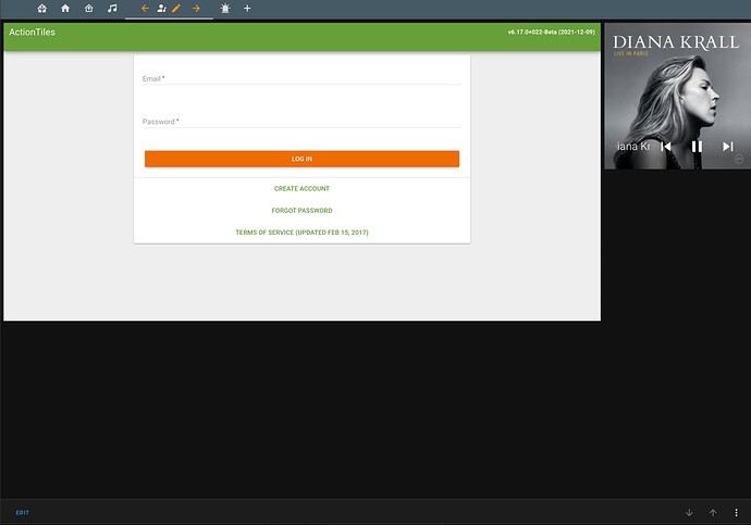

I wonder if I can get some help with the height of iFrame card. I was able to put the Sonos card next to the iFrame page. Please see photo below. However, the iFrame webpage (ActionTiles) is very short. I looked at the GitHub documentation, and it’s not very clear to me how I can make the ActionTiles dynamic or much much longer so I can have the iFrame can touch all the way down to the bottom of the screen. I put the yaml code below. Can anyone please help me how I can make iFrame longer?
type: custom:layout-card
layout_type: custom:grid-layout
layout_options:
  grid-template-columns: 80% 20%
  grid-template-rows: auto
  grid-template-areas: |
    ā€œleft rightā€
cards:
  - type: iframe
    url: https://beta.actiontiles.com/panels
    aspect_ratio: 50%
  - type: custom:mini-media-player
    entity: media_player.sonos
    artwork: full-cover
    sound_mode: full
    info: scroll
    scale: 1.7
