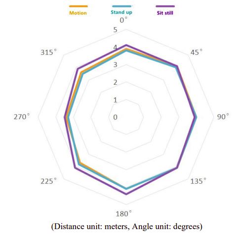

Looking at the datasheet for the LD2410 it looks like it has a slightly wider range on the vertical when mounted horizontally, but there isn’t much difference. The left side seems to be the poorest and its probably the wiring connector impacting it.
This diagram shows the range when mounted on the ceiling:
LD2410-range1
LD2410-range
Unfortunately, I can’t find a datasheet for the LD2410C which has a different form-factor so its range coverage might be slightly different.

Well I just did some initial testing with mine and I found it to be very sensitive in orientation differences. Here it is at 0 degrees if I rotate it by 90 I find it to be very sensitive to the horizontal plane which is not working in my case. I could lower the sensitivity but then there could be some false negative especially after gate 4. I was hoping to mount it at 90 degrees for aesthetic reasons but it’s still early on testing.
Forgot to change from C to F. (Corrected)
Looks like you are using a LD2410C which has a different form factor to the LD2410A/B so its range coverage would be different from the chart I posted above. Good to know the LD2410C has different sensitivity based on its orientation so adds more options for case design and mounting depending on the required coverage.

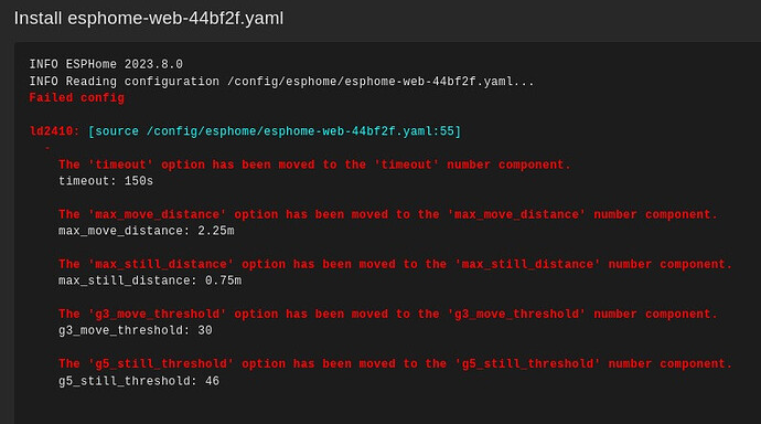

is it me or did the LD2410 config of esp home changed so drastically that it broke the old component and configs?
I can’t even open the logs anymore due to the errors in the config:
I have found some new config examples for the number thing and the sensors, but eventhough the config itself is accepted, the compile it not accepting it, so if somebody has a working example with the new number components, that would be great… (or a fix for this old config if that is possible under the old LD2410 component…
Is it me or do people have a problem reading changelogs in this community :smiley:
I know, but reading through the docs and looking for examples with the number component still doesn’t work as mentioned in my post…
Do you have a example of your yaml file? I´m in the same boat
My working config on esphome 2023.8.0 (All copied from the docs)

Docs? Don’t spout that docs crap… :slight_smile:
ah that seems to have been my mistake, the docs referring to the number component for the timeout and G values and such, and looking into that it mainly stated things I didn’t need and because of the writing I assumed that it needed to be configured in the yaml as previous, but the new config leaves everything blank and let you set the values in HA in the entity itself. Way easier to config this way then recompile every time, but the docs could have been more clear about this and state a full example…
I copied yours and it now works like a charm again :slight_smile:
I mean, this could have been way more descriptive…
