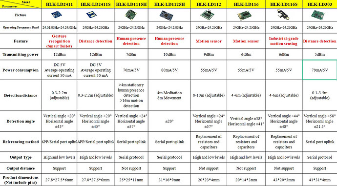

LD2410C vs 2410B vs LD2410S vs 2411 vs HLK-LD2420 vs LD2450
Has anyone done a detailed comparison of all these radar modules by hilink?
I have 2410B, 2410C and 2420, I found 2420 easier to work with, and it was recommended by the sensor guru @Blakadder.
2410B and 2410C use the same code and have many configuration options. but are taxing on the esp32 boards, use either ESP32S2, ESp32S3 or ESP32C3 boards with these sensors.
On the other hand, 2420 was easier to program with, I am even using an SSD1322 256x64 3.12in OLED display, Bh1750 (I2C bus) on the same esp32 as my LD2420 sensor.
I don’t have LD2450 on hand but whenever I get my hand on one I will amend this post.
5V sensors are 2410B, 2410C, 2411S
3V sensors are 2410S, 2420
Here is a spreadsheet I created comparing these all from Hi-link website, errors and omissions are possible, please suggest any changes.
