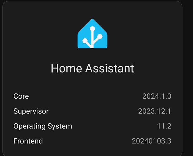

I decided to opt in to the beta channel last week as I was really curious about some of the candidate features that was planned to be released. When stable release got out today I decided to leave the beta channel. So I did this by selecting the option “Leave beta channel”.
However, the version for operating system seems to be “stuck”. I made some attempts to Google the solution but most hits was concerning the Supervisor.
Sure, the Supervisor also needs to get an update and here I followed a thread to set supervisor to stable ( ha supervisor options --channel=stable) and then reload supervisor, but no luck either.
Any ideas on how to solve this?

he is on supervisor 2023.12.1 … im not !
Missed that. Thanks:
ha os update --version 11.2
ha supervisor update --version 2023.12.0
