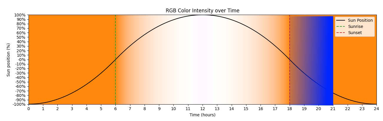

There is a config app on the adaptive page that lets you visualize the curve the lights will follow. You can make multiple adaptive configs. You’ll need to make 3, 1 for each phase. Notice that when I invert the brightness values, the peak of the curve is red and fades to blue.

I need it like that. But I can’t do the blue transition in the evening:

As I said you can make more than one adaptive config for the same light. So for example at 7pm it would switch from config 1 to config 2.
