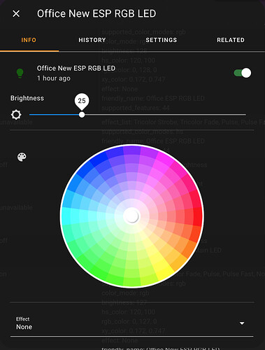

However, this screen shot shows that the actual brightness is only at 25 - and that matches what I am seeing on the LED itself.
Does anyone have any ideas what might be going on? This is an issue a night, as the auto-dimming I have has a floor of 10% (since the LED can’t dim much more than that), but the actual brightness is around 7% when I do that which turns the LED off.
