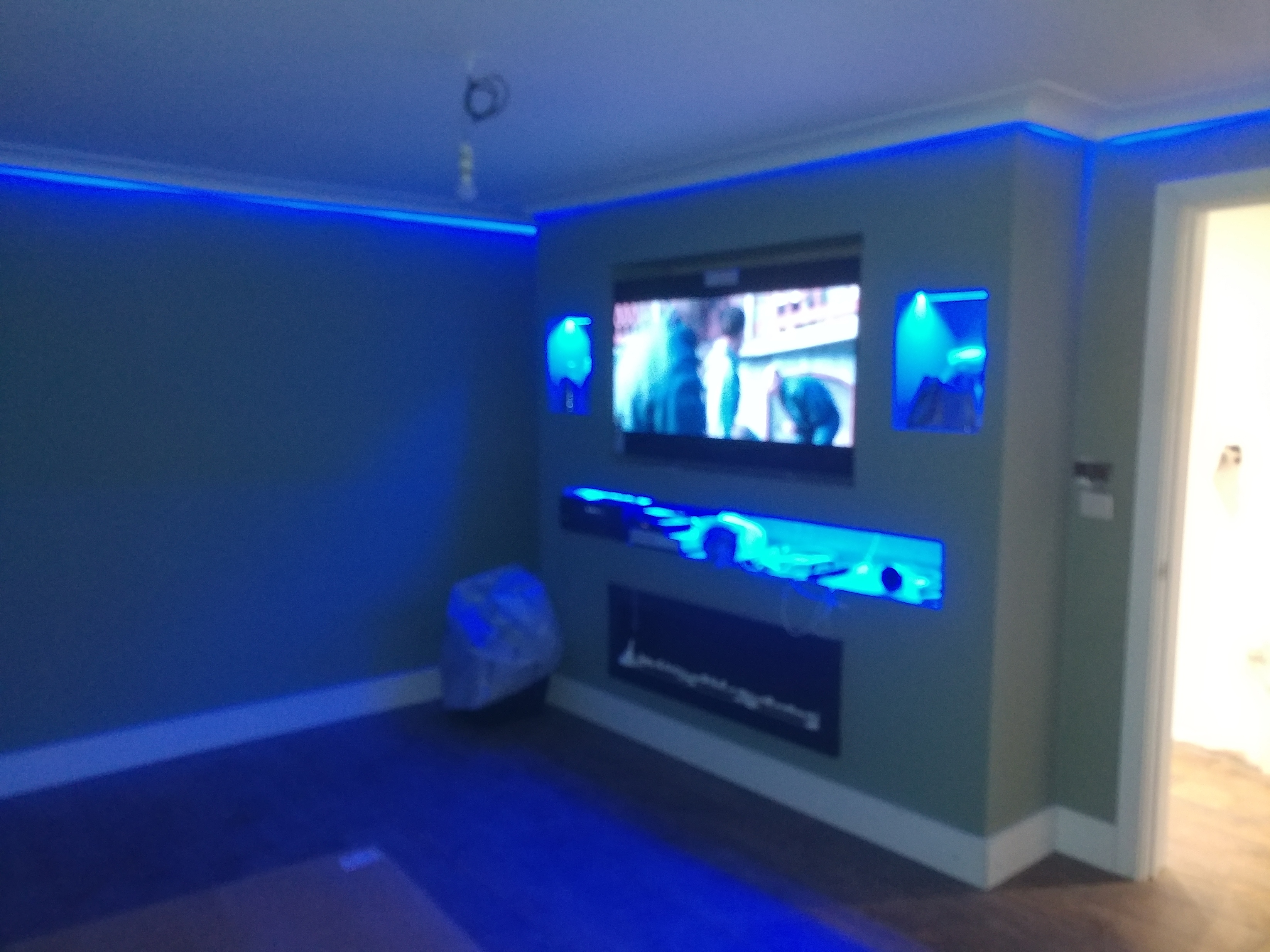

I’ve use cheap rgb strips, used mi light controller with WiFi adapter, got them in kitchen and living room coving, can change colour too, looks great.

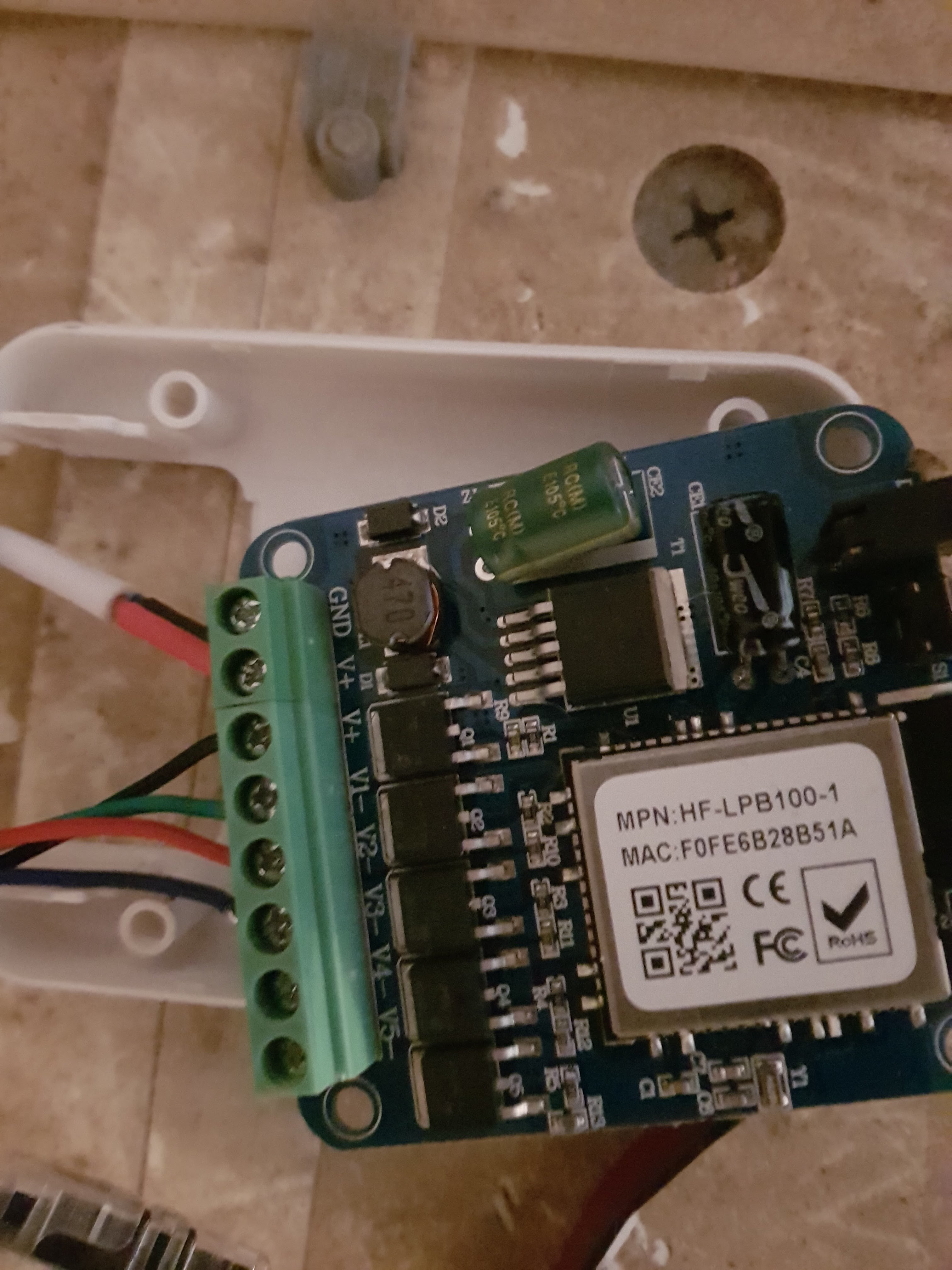

but the MagicHome controller I have appears to have failed.

do you know of any way to determine for sure if my MagicHome controller is dead?

my controller looks different to the ones in the wiki?
I once read that there is almost no way to “brick” an ESP in software, so unless there is a hardware failure you should be able to reflash it. If you have a programmer it’s a 10 minute job, it could be worth trying.
If the form factor of the board is different it is only a matter to find the right connections for the programmer, basically if they use the ESP 8266 they are all the same stuff.
Ah ok, I’ll give it a shot then.
I’ve got one of these
Is this the right ‘tool’ for the job?
Yes, that’s it :+1:
