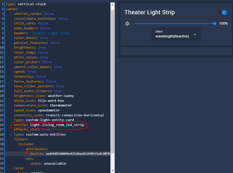

I need some help. I am trying to integrate LedFX into Home Assistant.
I have Led light strip set up in my living room using esp32 board. I have wled. I am able to use the wled app and control my lights. I then downloaded ledfx and installed it on my pc. I have an audio input going into my pc. I am able to get the lights to respond to the audio input using the ledfx app.
I have downloaded the LedFx deep integration component. I am able to see my led strip device.
I followed the steps and installed the lovelace-auto-entities and light-enity-card.
I created a lovelace card and copied in the example text:
It shows me the basic light controls. I can change the effects. But I am missing the next card which has the attribute settings. I can’t figure out how to get this to display. I am confused about what should be put in for the device. The example document says your_device_id. I had a hard time finding this and am not sure I found the right one. I started to create an automation and added my led strip. Then looked at the yaml code and saw a device_id. So I added that here, but it doesn’t seem to work.
Also, the power switch is very finicky. When I turn it off. It usually turns itself back on in a couple of seconds.
Anyone got any ideas on what I am doing wrong?
